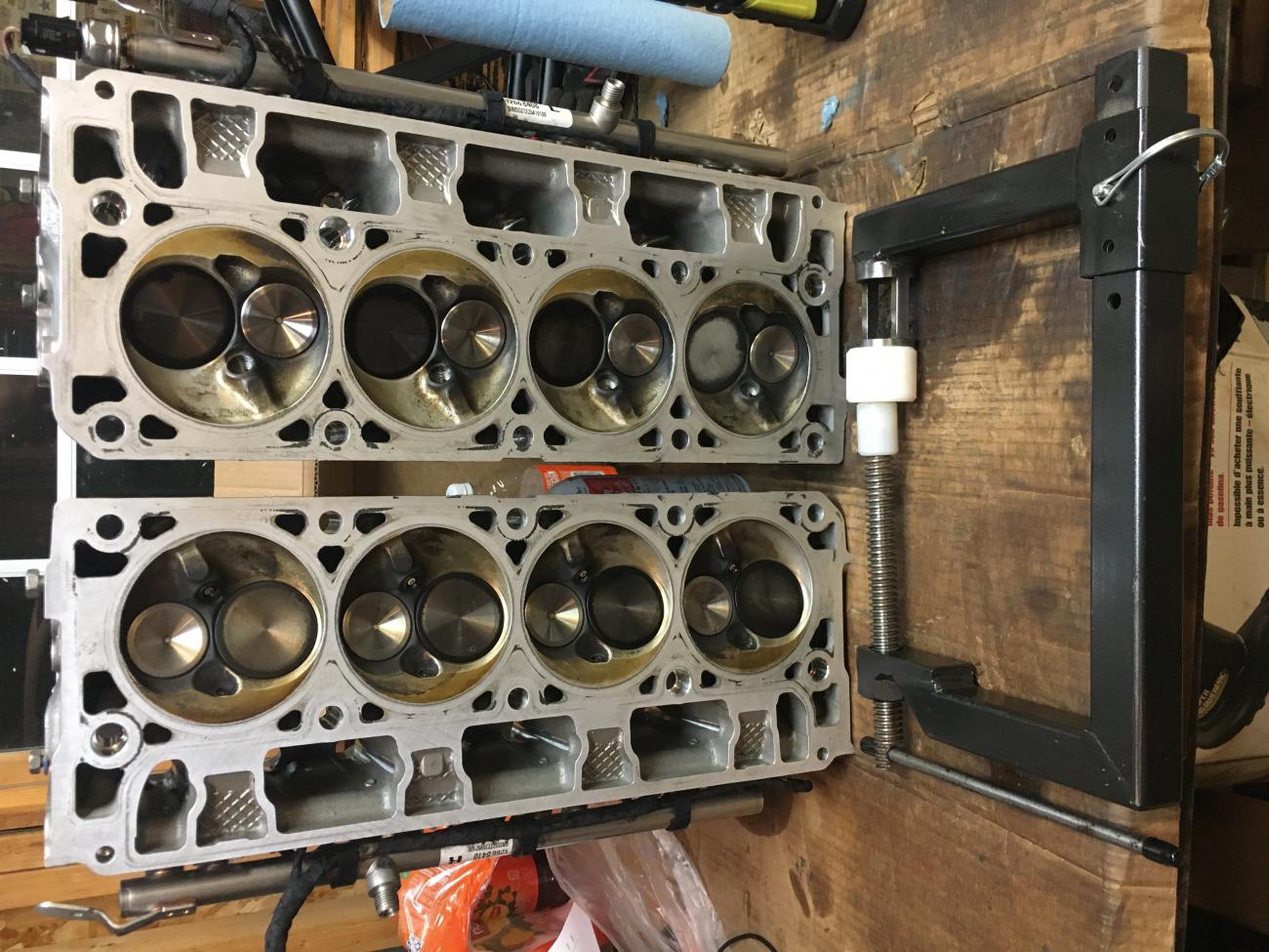

Found no damage. Now just waiting on new gaskets to show up. Did a quick leak Down test by pouring m1 down the intake runners and let them sit for 30 min. No valves leaked. Good to go.

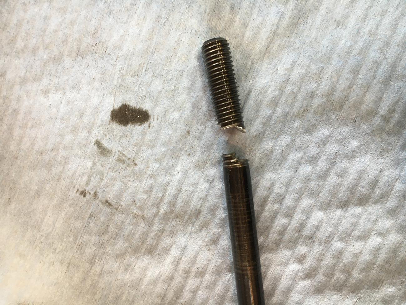

Another kick in the nuts. The last head stud snapped off in the block today. I'm really hoping I can walk it out tomorrow. I need to search around to order one stud as a replacement.

Walked her out. Ordered a replacement from arp.
