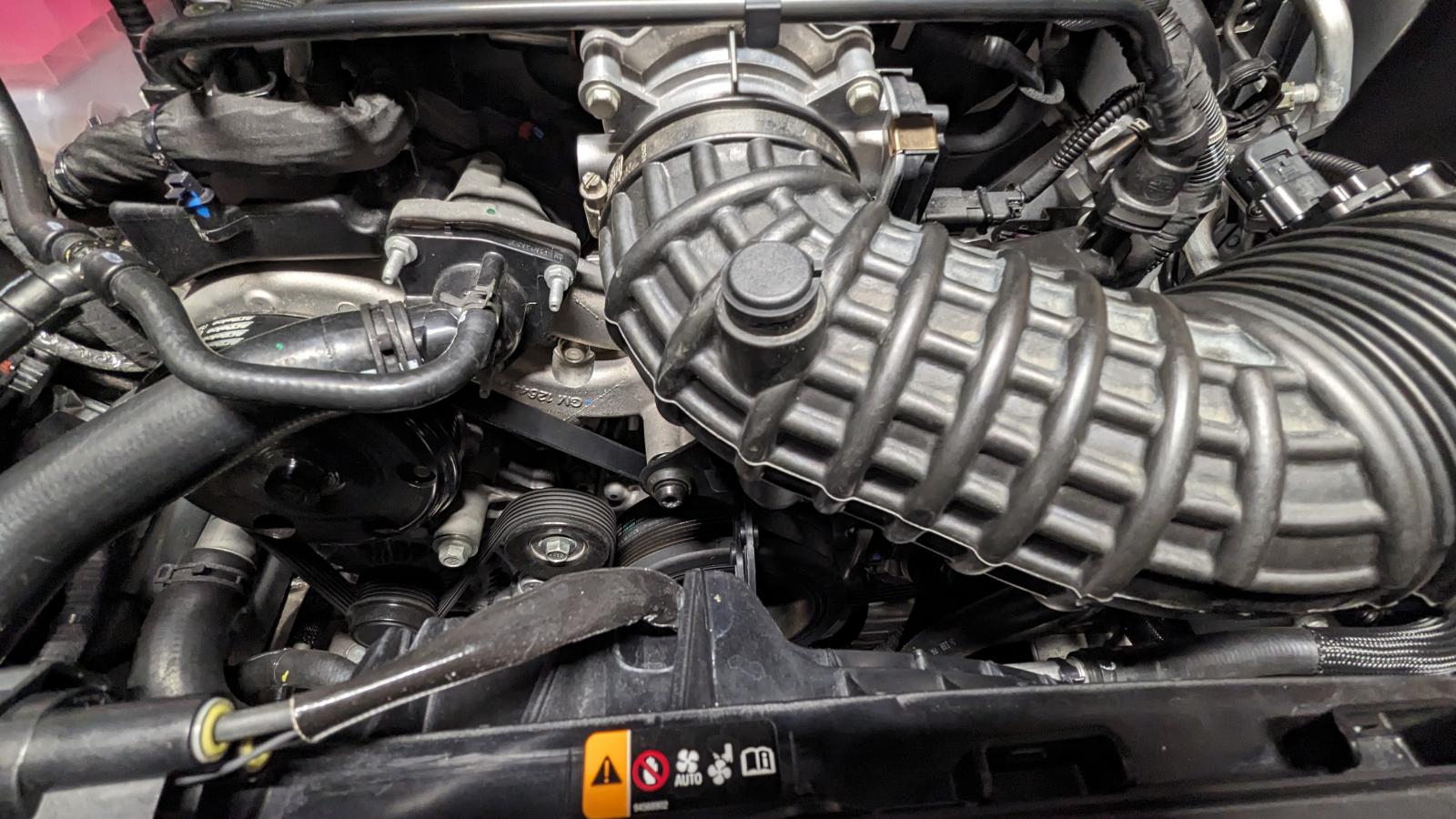

I ordered the plug from Phastek but this one from Amazon looks super nice and clean

That looks like the hillman plug with a plastic clamp. I pried the stock metal clamp by twisting screwdriver until I could remove sound tube. Then recrimped it with diagonal pliers once plug was in place.
Amazon kit looks like they discard the stock clamp.

My local Ace hardware didn't stock the Hillman brand. I looked on Amazon and found the exact ones from China. It fits nice and snug. I didn't like the ugly stock clamp so I got rid of it. Looks neater without it, IMO.

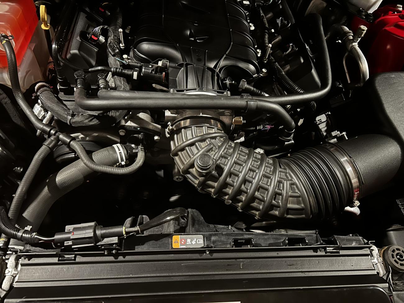

+1 for the hardware store $2 sound tube delete kit. For the firewall, I just dremel’d the end of the sound tube where it attaches and slapped the 2nd 1” cap in the hole. It’ll suffice until (and IF) I go aftermarket intake

I used the 1" plug with a small dab of black RTV. Just enough to hold it there in case I ever want to pop it off and run something through the firewall.
