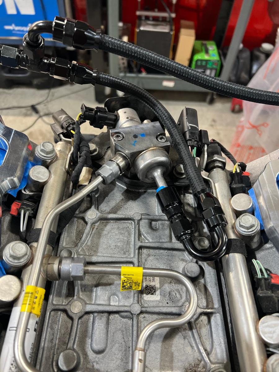

Originally Posted by ZLAV1N View Post
I'll snap some better pictures of the engine bay & post them up now that I have the car back. In the meantime, here are a few more of how they ran the fuel system and Holley ECU.

Originally Posted by Brianw36 View Post
Nice setup. Do you know what AN size is the fuel lines? Does the fuel go to the front of the fuel rail and then through it to the flex fuel sensor? It looks like fuel would go through the rails before ethanol is read. Unless I'm just not understanding setup.
These are -6 lines (rails are -8) as it's connected to the factory Camaro feed line which is -6. You are correct on the routing, we are feeding the front of the rails first. Since it's a return-less system we want the flex sensor close to the HP pump for 2 reasons:
1. any switchover from pump to E85 is normally going to happen at cruise - in fact you want it to on a return-less system - especially if it's a big change. You want the fuel in the rails before it hits the sensor, then makes it into the DI right after it hits the sensor.
2. FF sensor does have a bit of restriction, placing it after the rails lets full flow to the port system with the slight sensor restriction only effecting the DI side.
If this car was switched to a return style fuel system I would put the FF sensor after the pressure regulator in the return line to the tank.
Mike thanks for the informative description.

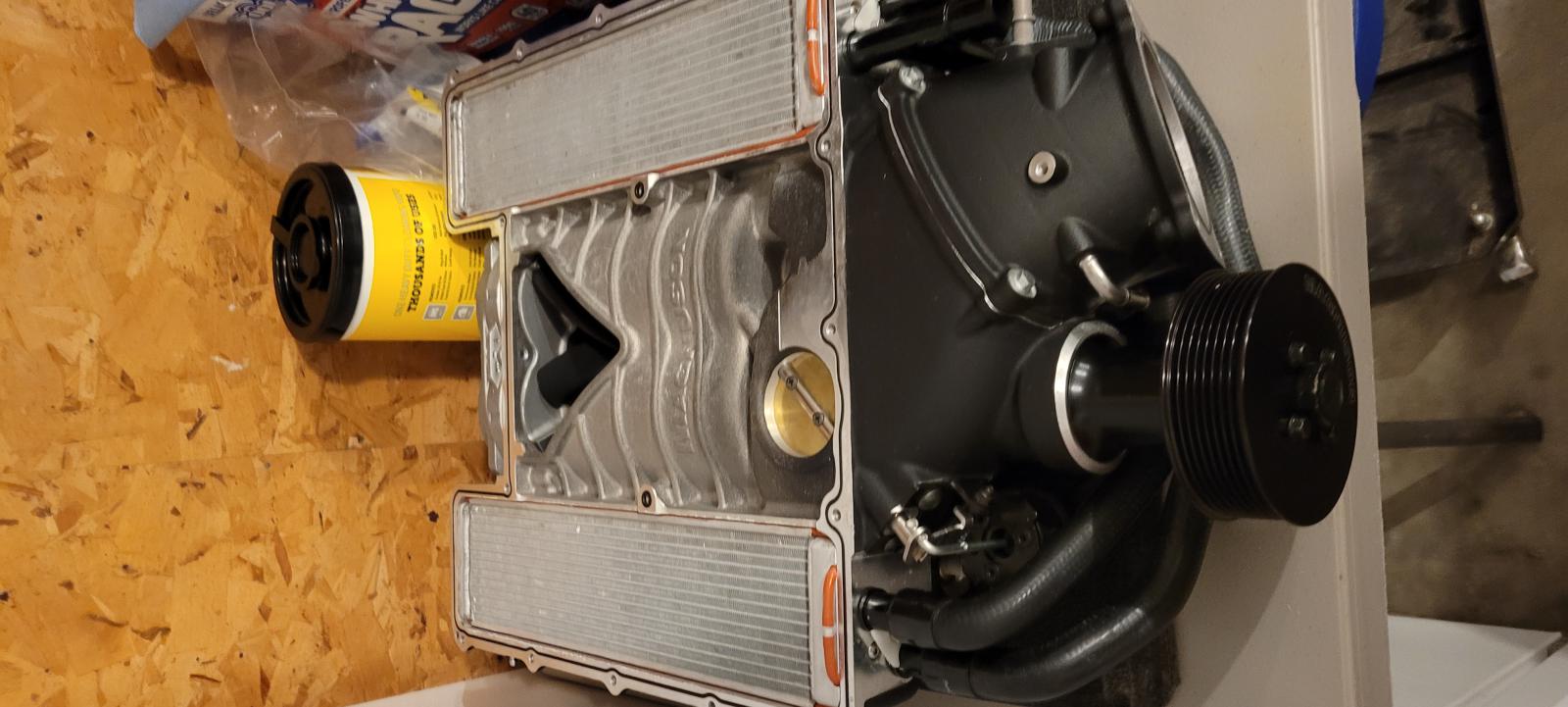

Old 08-19-2022, 03:34 PM   #42
laynlo15
Drives: 2022 Lt1 A10
Location: clark, mo
Posts: 8,882
Posted a few more pics in my first post. Received two of the 4 boxes today, so check out the new pics and also added a C7 Heartbeat lid, we had some concerns the taller lid might hit the hood but I will verify that so if anyone else decides to got PI with their 2300 you'll know if it will clear or not. I really like the C7 lid, I'm sure some will ask if its a Whipple and must admit it kinda looks like one also. Also painted the lid and clear coated the blower case, looks much better than that rough shit they cast it out of.
