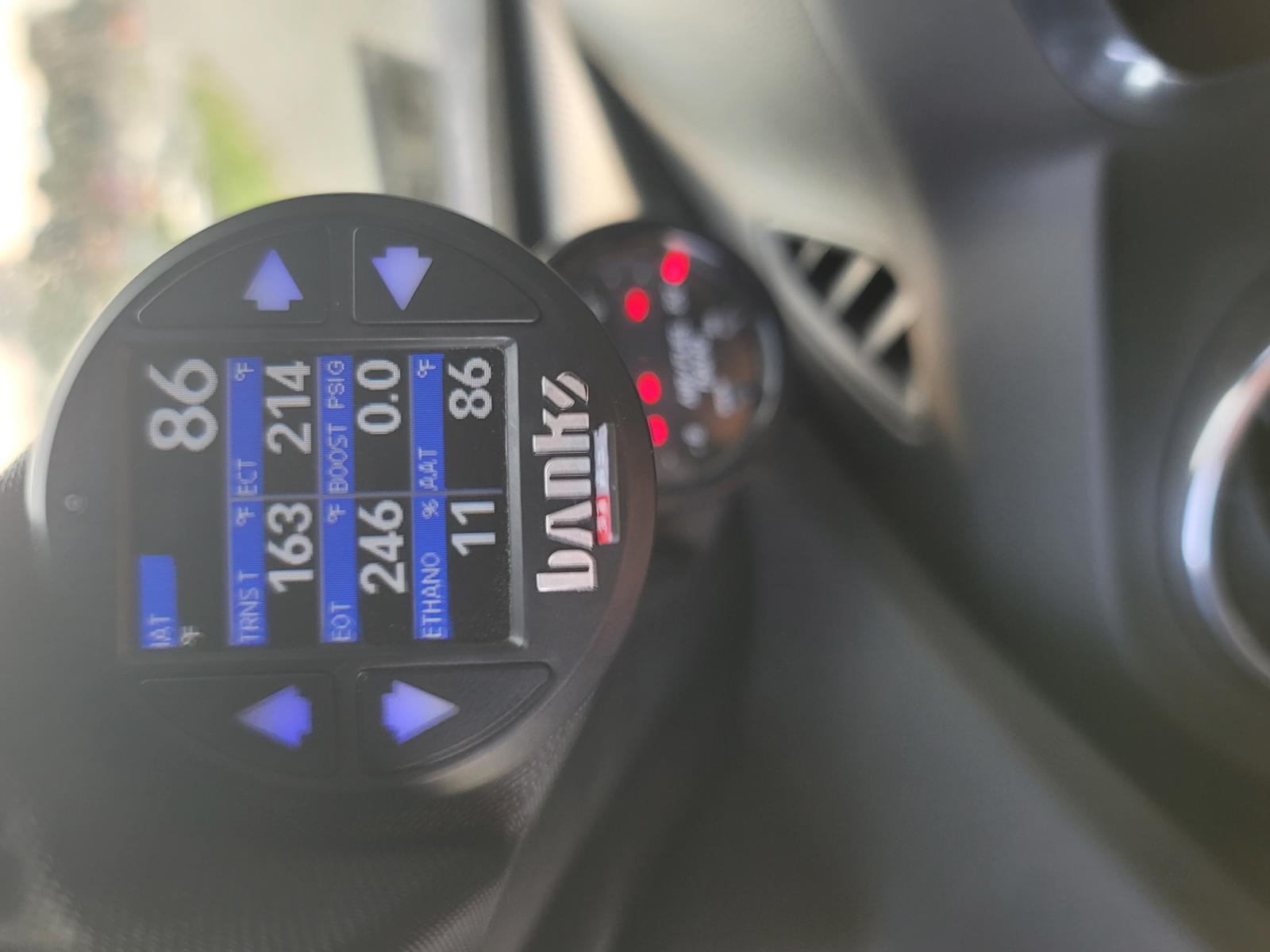

This is a 20 minute street drive with some hard long pulls. Not sure if oil temps and coolant temps are still to high. Not sure what else I can do.

The 174 stat will help keep the car cooler at cruise and idle compared to stock. When its fully open, its fully open though and when your on it, nothing else besides better HEAT EXCHANGE will keep it cooler.
Make sure your fans are adjusted properly. I have mine set to come on at like 39% at 180F, then like 79% @ 185F and 190F they are at 92%.
Stock those damn things dont come on till the temps are like 210.
Oil temp of 246 if your doing pulls is completely normal, it will go back down at cruise.
