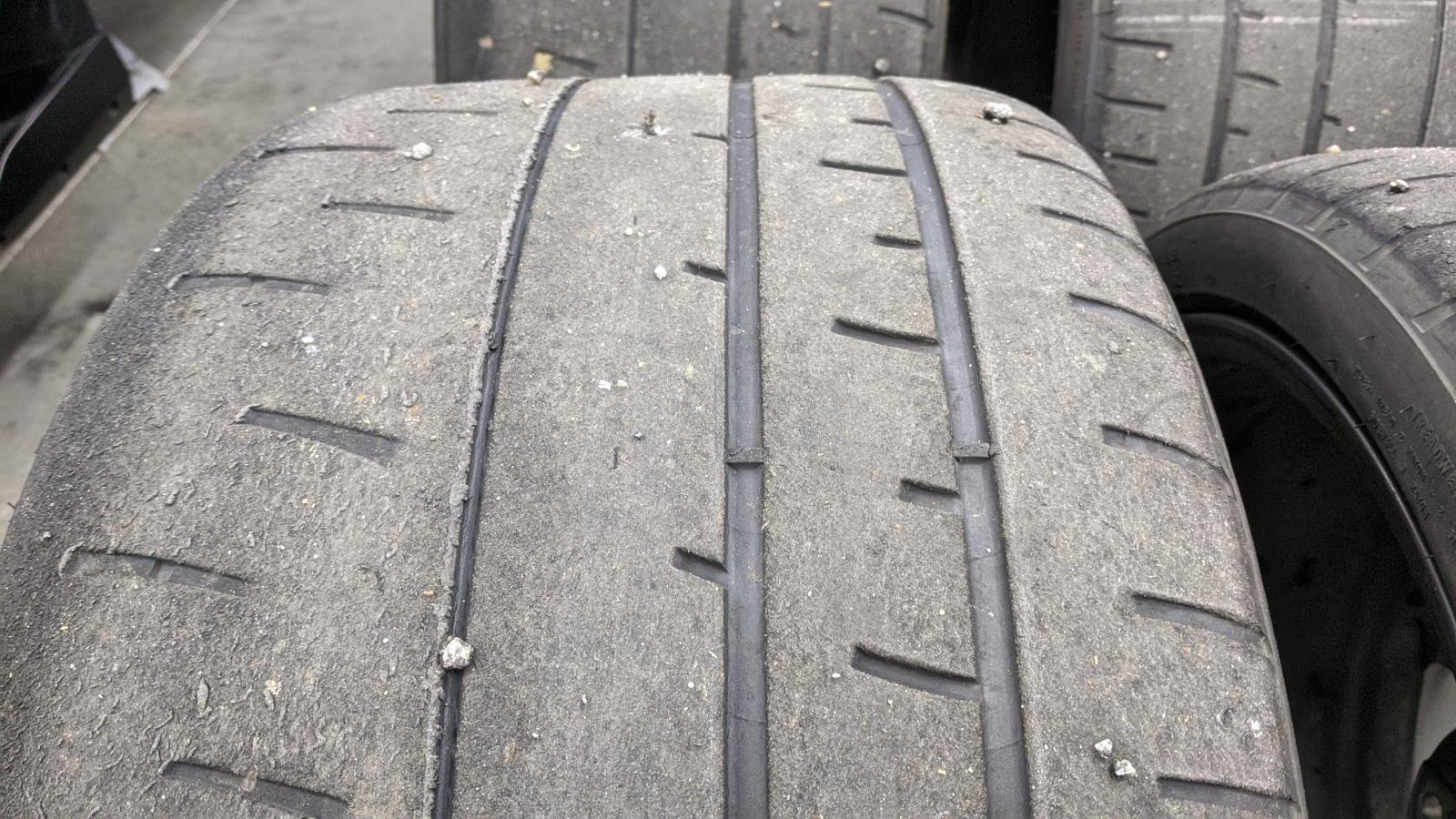

I got the BMR Radius spherical bushings installed earlier this year on my Camaro ZL1 and on a 19 corner track technical track that I drive very hard and aggressively on, I'm happy to say that I've made it past 2 track days on the SC3R with no cording and the outsides look like they have less tread and more wear on them than the insides. My front camber is -2.7 although I was told camber has very little to do with why the front tires cording on the insides first. Someone said it was "dynamic toe change" in the corner due to stock rubber bushings. Not sure if that true or not but last track season, my SC3's corded on the insides not the outsides.
Once these tires cord, I'll send pics, but right now it looks like they will cord on the outsides first.
Tire temp is 37psi when hot.
Yes, please post pics when they do.
Wanted to get spherical bearings, etc for my C6Z, but upgraded to the ZLE. I assumed the ZLE had very little compliance, at least small enough to not have significant change in camber/toe during loading.
Have any ZLE owners gone to spherical bearings?

I had bad luck with toe out. I set mine up for .06 total toe in (pos toe) for my first track day and the right front wore the inside aggressively. I rotated left to right and the right front wore aggressively again on the fresh inside of the rotated tire. The left front wore well over all. This was a right handed track. Followup alignment check showed that the suspension "settled" and the toe changed to total toe out to about .1*. I have read that others have had trouble with the suspension "settling" during the first track day also. My next plan is to go total toe .1 pos (toe in) and I may put less camber in the right front to help with better heat distribution across the right tire.

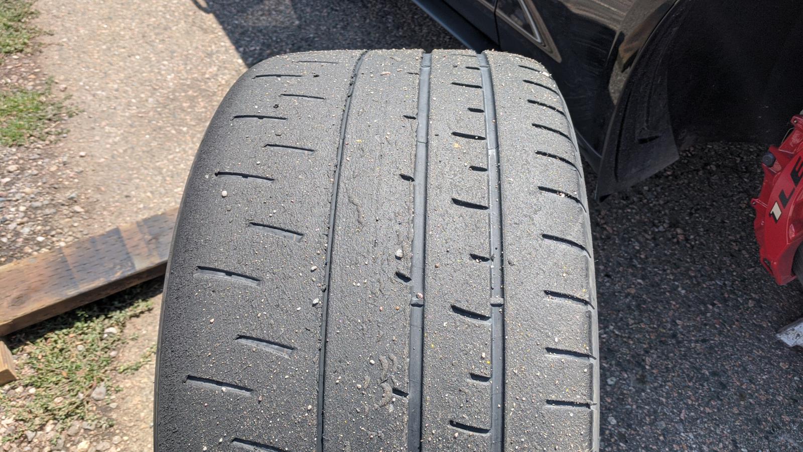

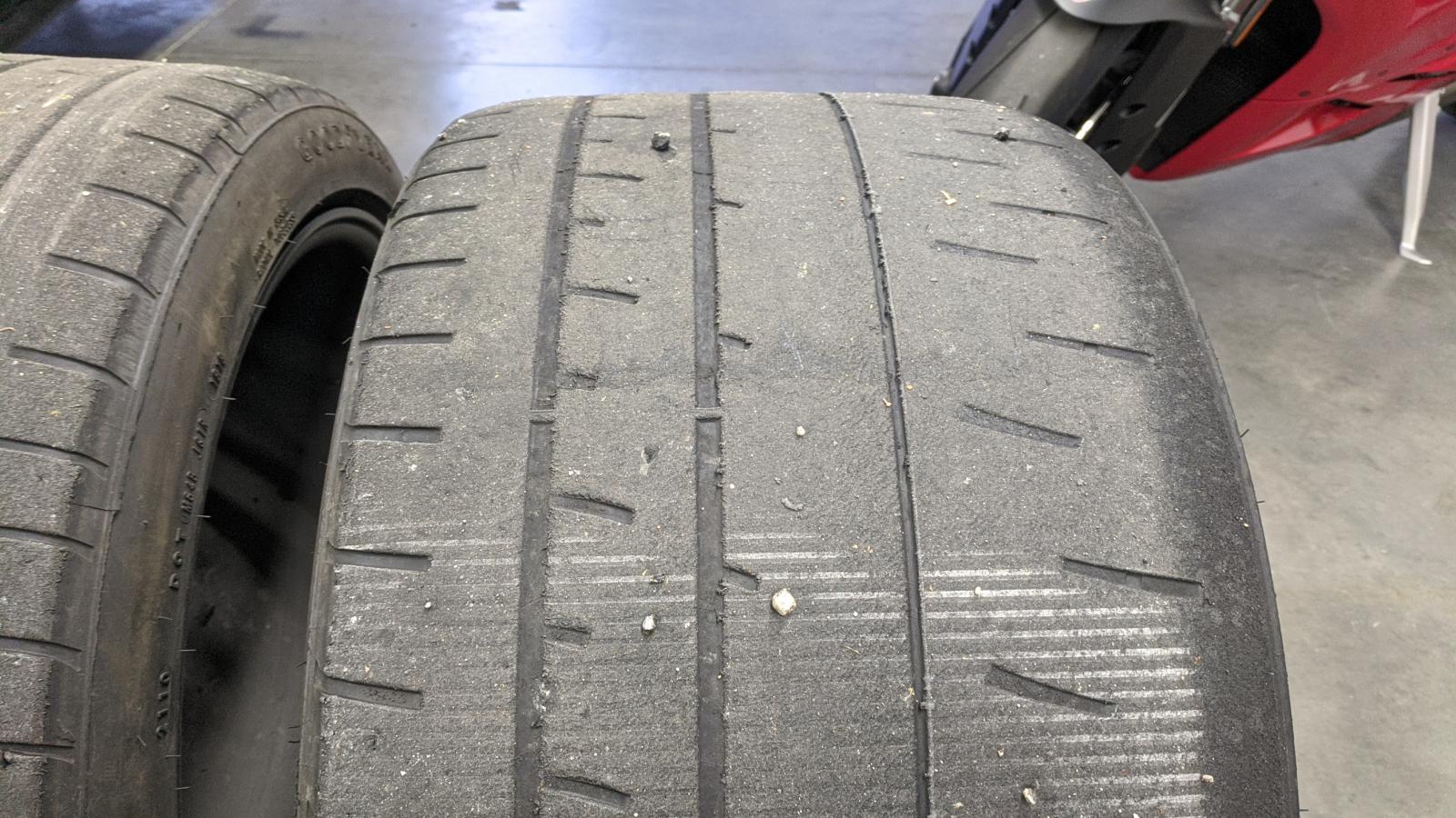

Following up. Did a track alignment on a hunter rack. Went home and checked the toe using the string method. It was set at .1* toe in and the string showed the actual toe to be zero. So I set the front toe to 1.5mm toe in total and set the left front at -3.1 camber and the rt front at .2.6. Left front tire pressure worked good at 41 and rt front at 40 hot. Rears were -2.1 camber and total toe at 1mm. rear tire pressure was at 33-34 to get good heat gradient across the tire. The fronts were new and rears had about 230 miles of track use prior the the current setup. I got on track two days ago for about 100 miles total. I got better wear but I can still see the very inside edge of the fronts getting scrubbed. Attached pics below show fronts at half day rotation and then all four at the end of the track day. The car worked great and I was 4 seconds faster than my well prepped 500 RWHP c5. I will change front toe to 2mm total for the next day to see what happens.
Wow, your fronts look better than my rears!! Those are 3Rs, correct?
