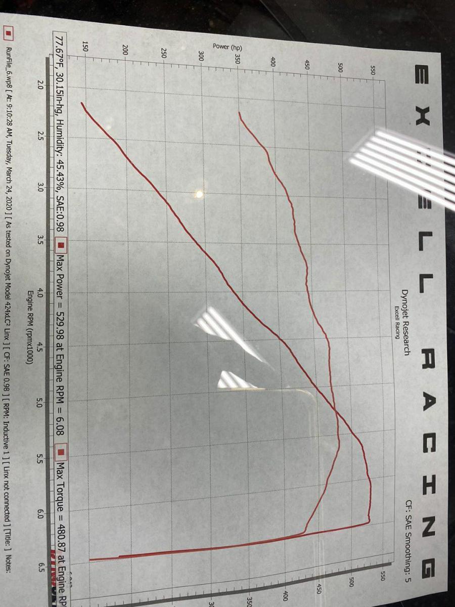

Today I got the dyno results of my cam/heads/converter install! Pretty good numbers for just having a stock IM!! 530/480! Sorry, I dont know how to rotate picture.
The final mod specifications of everything was:
VVT3 Cam - TSP
Ported Heads - TSP
3200-3400 Stall Converter - Circle D
95mm ported Throttle Body - Solar Performance
I already had:
Long tube header
Intake
E85

Looks good, but I'm confused why the dyno run does not go to at least 6800 RPM, this is a 7200 RPM cam (not talking about peak). 6500 is way too soon lift. There is no "MSD dip", I do think the power curve should be rising instead of flat from 6000 to 6500 so that means the IM or the air box is probably holding you back. Also note the CF is negative the car is making even more power to the wheels...
