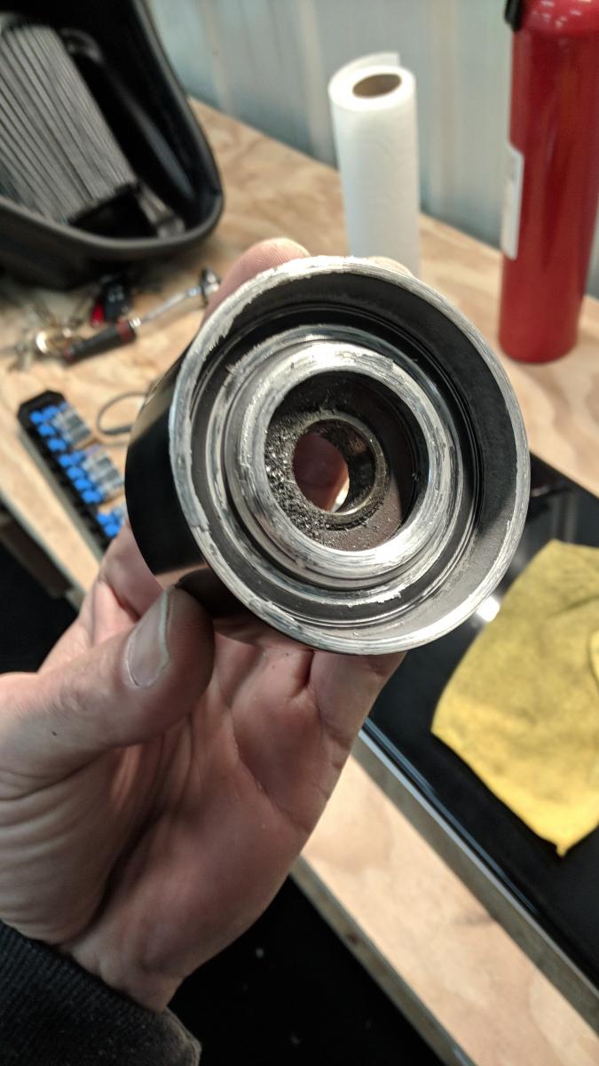

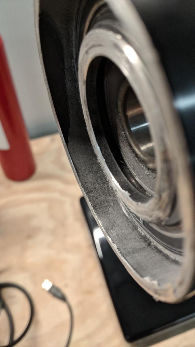

Well I found the issue. Whipple didn't press the tensioner bearing in the pulley all the way. This was causing the pulley to rub the tensioner arm. There is still a little noise coming from the Whipple buts it's nothing like it was. You can't hear it with the hood closed...and with it open you can actually hear the whistle and direct injection ticking now. Lol

Yeah I knew something wasn't quite right and the more I listened it sounded like a pulley amplifying the noise...kind of wierd actually. So I pulled the intake elbow and belt off, then started rotating pullies and the tensioner was just grinding metal to metal.
I am also going to put a longer belt on. The tensior is 7/8 from Max and the pulley with the slide adjuster is all the way to the left making the belt a total PIA to put on. The belt is a 816, gonna try a 820 green.
