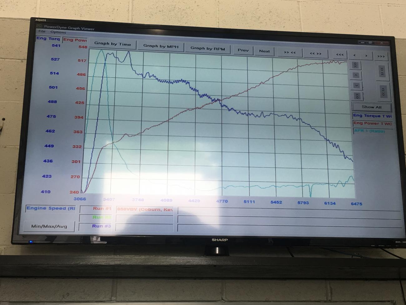

541 Torque 548HP on a hot summer day with a 100 shoot. Mustang Dyno
NA run 480 - 440 HP with heat soak. I am not totally happy with power numbers but very happy with sound.
