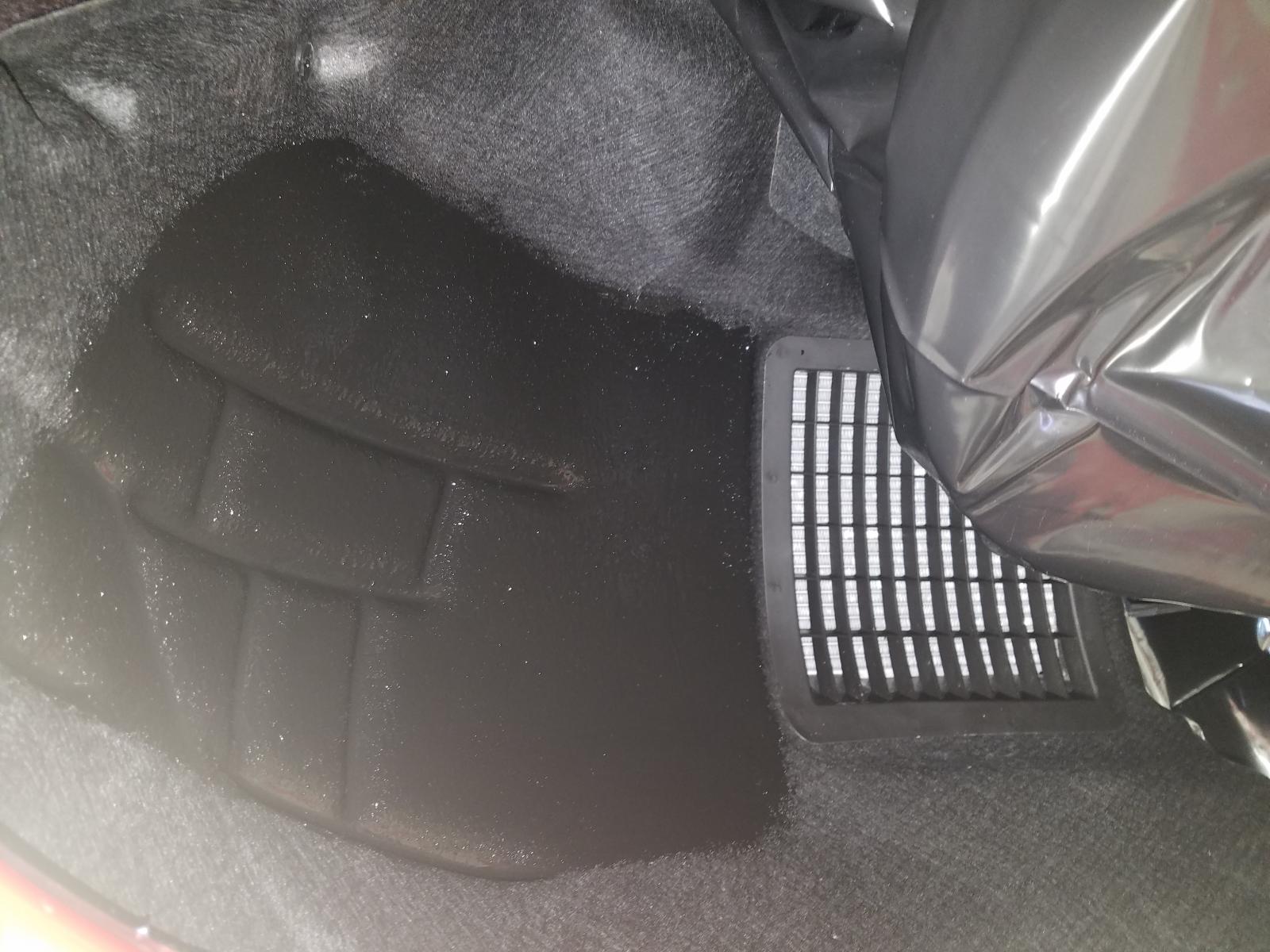

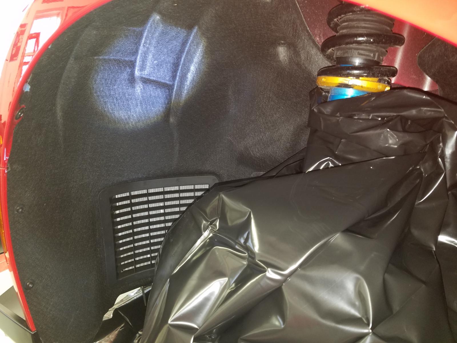

Fixed it.....I hope....
Coated the problem area with Flex Seal this morning.
First pic, the spotlight is on the area that was penetrated first. Highest impact area.
Second pic is after a couple of coats of Flex Seal. Not hard to do, stuff is pretty thick so hangs on the fabric well, just went over it a couple of times. Found out a 2" brush works better than a 4"roller to apply it.
Interesting thing is....both the tech that replaced the liners and I believe that the replacement liners felt a bit thicker and harder than the originals. Maybe they started making them a bit tougher now?
Regardless, I expect this to solve the problem - and - likely is only an issue with tough track duty not DD.

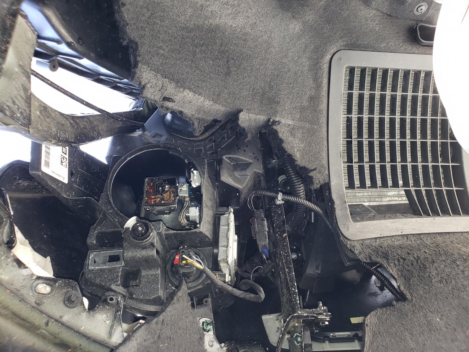

So you think yours was bad look at mine. 2019 zl1 1le. This is the left front liner, and all the rubber that I pulled out of the headlight. Plus there's a piece of rubber in the front housing of the headlight. I do track my car regularly.
Took to the dealer and hope they will warranty it. Also got a ding in the fender now from the underneath side due to no longer augh. Very disappointed GM!
