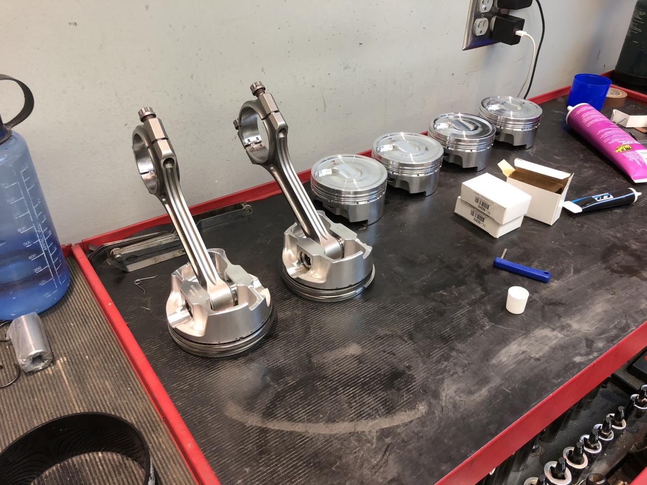

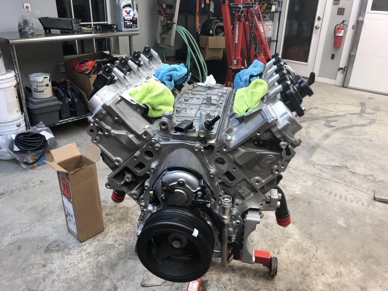

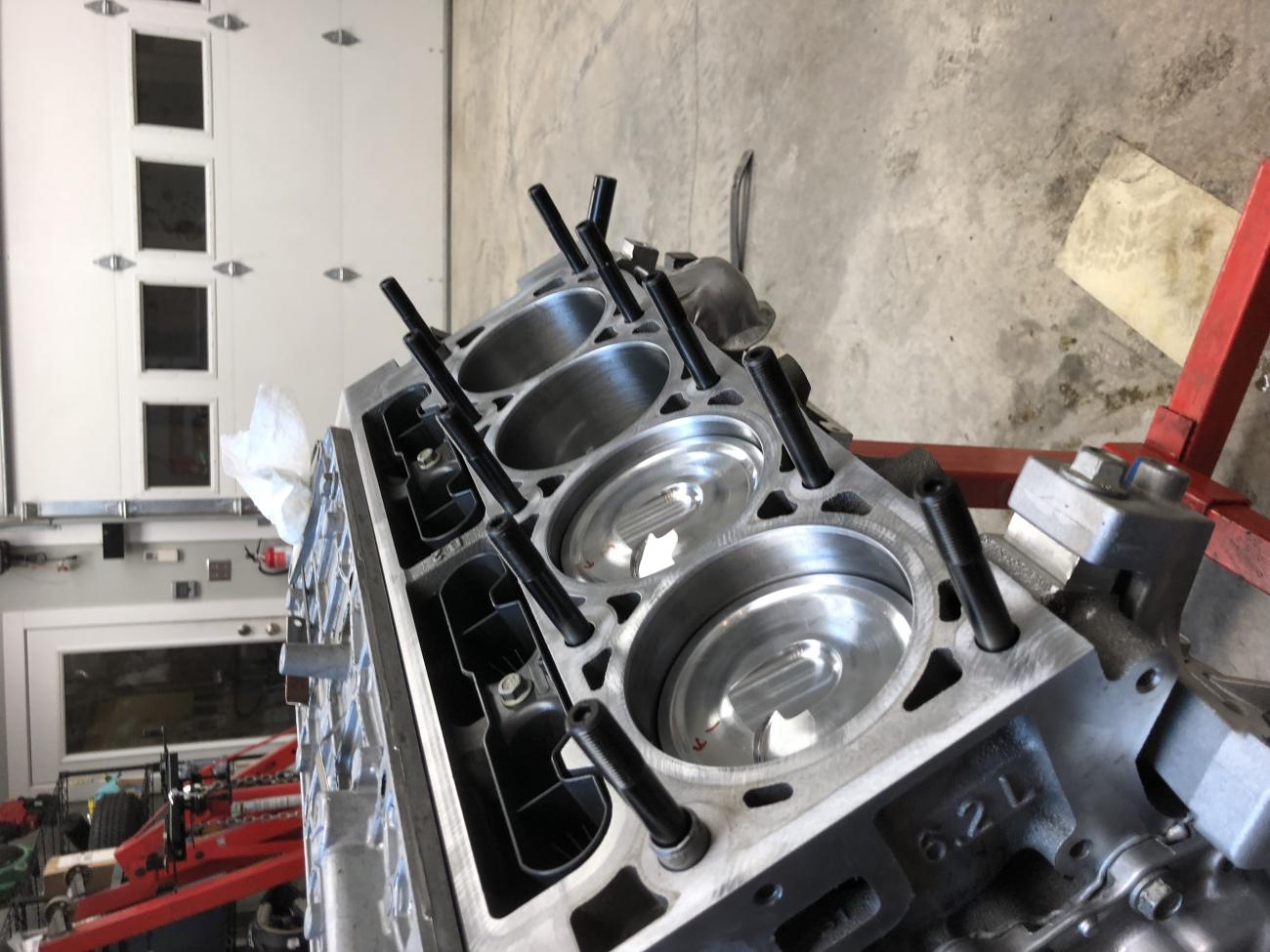

Made a little progress last night. I am waiting on a dod delete valley cover and then adjust and install the hpfp and injectors. Then I can start putting it back in the car.
I did weigh the stock pistons/rod set up and the new set up. Both 3lb 1.75oz but my scale only goes to 1/4 oz increments.
