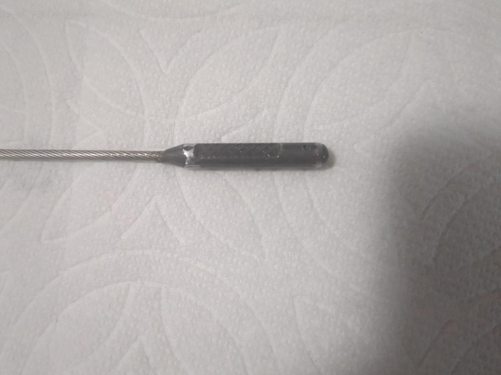

2023 must have a different dip stick , mine has no hash marks it's about an inch of gray plastic or epoxy with xxxxxxxxx. 320 miles since changed and at same place just below top dimple

Top of X to the bottom of X is a quart.
