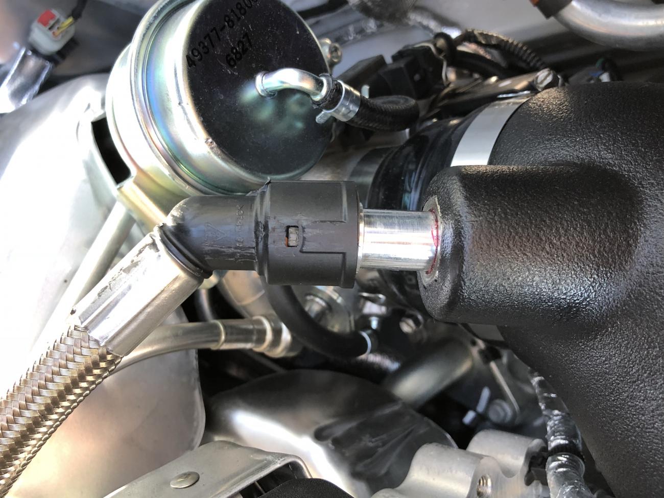

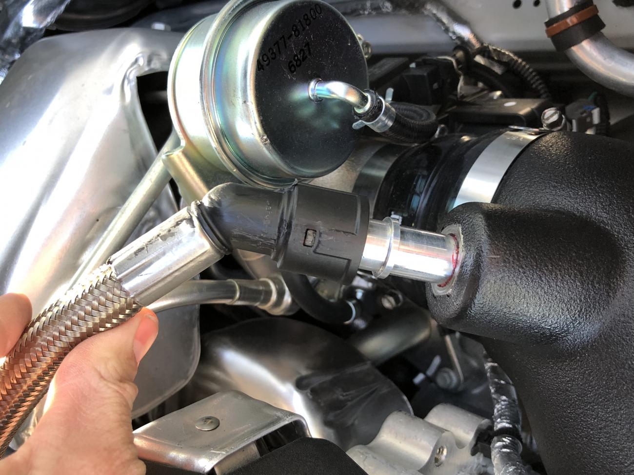

I had to trim the end of the intake tube side to get mine to snap on ('17). It was like it was too long and the pcv fitting would not reach the snap parts. I made several small cuts to the end of the tube until I could slide it on and it would snap.

Thanks Gutling. That didn’t cross my mind but could be the problem I figured Injen made it a perfect fit but guess not. I will post a picture later of it before I do any cutting. New to the forum and appreciate all the help guys!

No I have I the closed box Injen Evolution. The crank case fitting on the intake is metal. I have pics coming soon

Mine was the open box one, but fitting was metal. It apparently fit '16 fines but the change in '17 was what threw mine off. Not sure if the evolution one has the same issue between 16-17 but maybe.

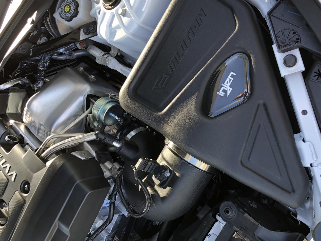

Looking at your pic it seems the connector is at a slight angle. Are you able to turn the intake pipe a little counterclockwise? Also I see that you have the newer box with the tinted intake window so they might have changed something. I ended up replacing the entire PCV hose with one from a '16 since it's such a stupid design IMHO.
