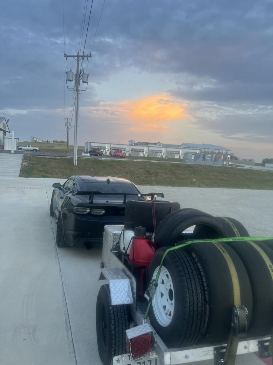

What's in the tire trailer???
I have been asked what I carry in the tire trailer that is pictured above and here is list:
4 Mounted Apex EC-7 ET25 wheels 18 x 11 with Michelin N3 30 65 18 slicks
2 SPARE Michelin UNMOUNTED slicks N3 compound 30 65 18 tires
5 jugs of E85 fuel holding roughly 28 gallons of fuel
1 SPARE trailer tire/wheel rated at 82MPH
Tools and FLOOR JACk in front mounted tool box
Note: The car EATS about 10 gallons of E85 per 30 minute track session and car starts out from home with 19 gallons in tank and arrives usually with around 14 gallons left in tank.
The trailer fully loaded weighs about 650 pounds and I can get about 14 MPG pulling it at 75MPH highway cruising speed. I installed a CLASS 1 hitch on the car to be able to pull the trailer. It takes me ABOUT 40 minutes to change over from the stock wheels and tires you see on the car to the slicks. I also change out the FRONT brake pads to a 3.12 compound from a Ferodo 2500 street pad compound. This whole process is repeated at the end of the track day.
This trailer started out life as a NORTHEN TOOL aluminum trailer that I bought from another TRACK RAT that carried his Miata track tires on it. I modified it to carry our size tires and then added some fuel jug containers to it so I could carry 5 fuel jugs (he carried TWO in it prior) I installed D-RING type straps to secure the tires securely to the trailer. I also changed out the trailer tires to a speed rating of 82MPH from the dinky assed 65 MPH rating that he had on it.
Why E85 you might ask??? Well ONE it has a cooling effect which is beneficial on the track especially and TWO, I have a 14:1 compression ratio LME NA 416CI engine in the car. The car will run OK with 93 but just not at the same power level or efficiency. As long as the E85 is 75% alcohol content or above the car gets full timing and power . The E85 I buy from KROGER is consistently E77 or E78 (I have a AEROSPACE gauge in the car that monitors THAT amongst other things).

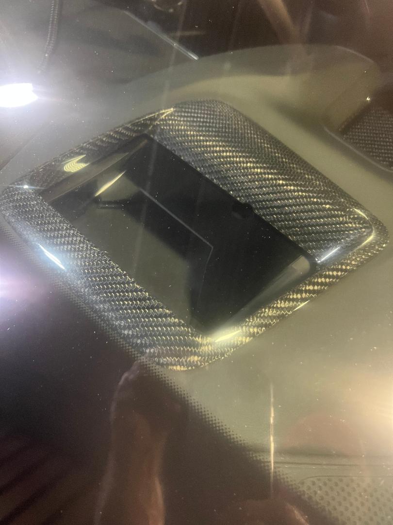

HUD Carbon Fiber Piece Installed
Just installed TRUFIBER carbon fiber bezel around HUD. PICS below is what it looks like looking thru the front windshield from outside the car. the SMALLER carbon fiber piece that is in FRONT of the HUD bezel is a CARBONADDONS piece.

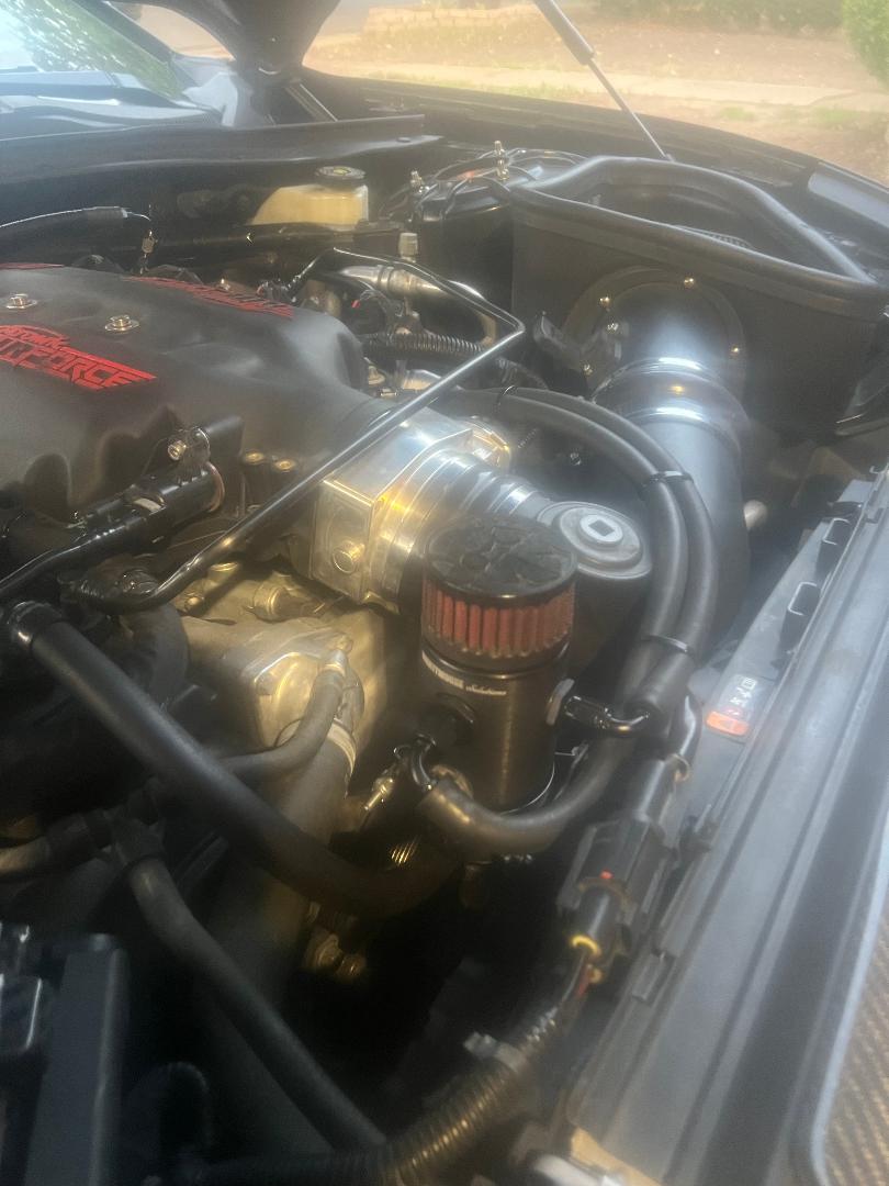

Breather Tank Installed
OK Yesterday along with a brand new A10 tranny, AMP installed a MIGHTY MOUSE breather tank on my car. For those unaware, the purpose of the tank is to vent the engine to relieve some of the crankcase pressure that if unchecked can push the oil past the rings resulting in oil residue in the manifold area as well as fouling out plugs.
Typically you see these on higher HP supercharged cars but since I have 14:1 compression and typically see sustained RPMs of 4500 - 5000 even on the slower parts of a road course; then we felt it prudent even on my NA 416 stroker motor.
I have another SCCA TIME TRIAL race coming up on the 12th of this month so I will be putting about 300 easy miles on this new tranny before then.
As you can tell from the length of this thread, I am just about to the end of the rainbow with the modifications on this car. It is pretty much EXACTLY the way I want it. If it were JUST a track car and NOT a daily driver, I would put MORE AERO pieces on it but thats just not practical for DD purpose.
NEXT mod will be to put more XPEL PPF on the nose of the car and in the area just BEFORE the back wheels.
PICS BELOW
