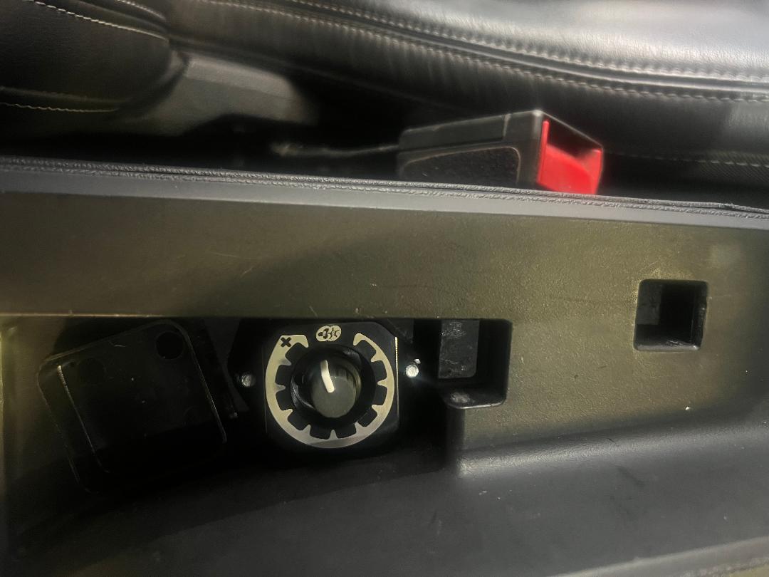

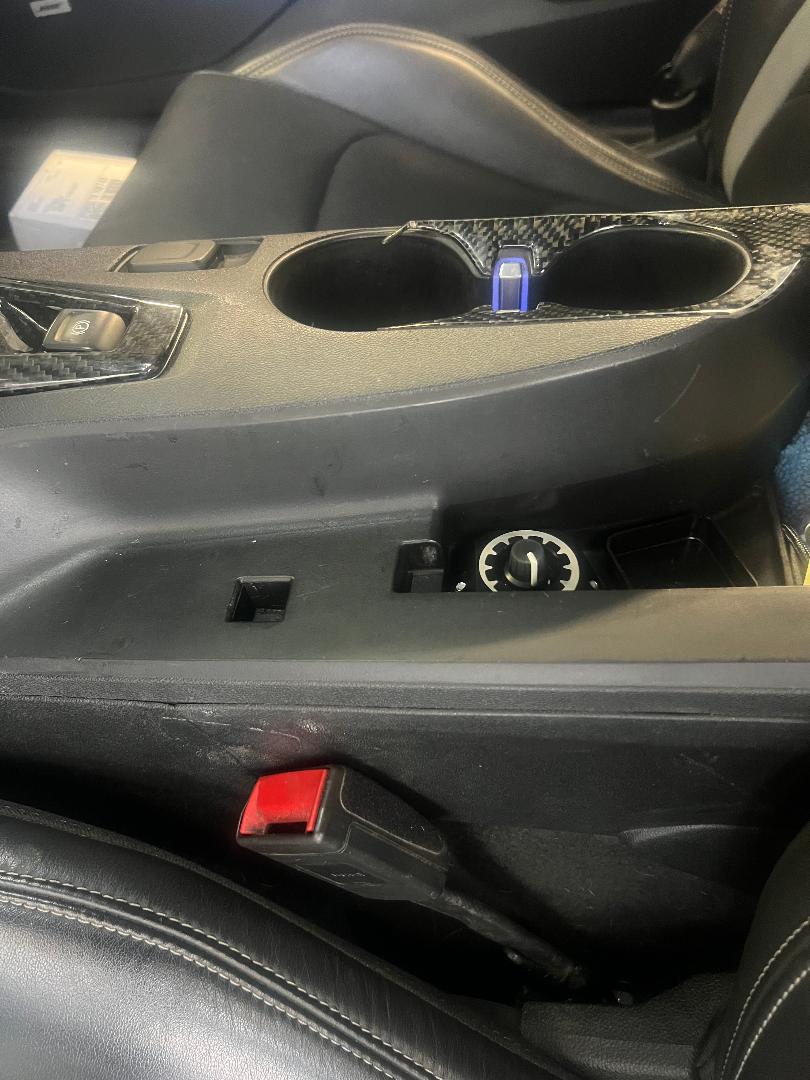

Ok guys, to provide ELECTRONIC control of the BOOST on this car as opposed to the OEM factory vacuum control, SMOOTHBOOST has been installed by AMP. This will allow me to manually adjust the boost on this car with the control knob you see in the pics.
The switch which has 10 position detent control knob that was installed under the console lid. You can either turn off boost entirely or you can modify the level of boost anywhere from ZERO to FULL boost which is about 14.5 PSI for my setup.
In testing it we noticed that the switch is NOT really linear. For example the difference between detent level 10 and level 9 is only about 20-25HP. But if you go down to Detent level 7, then the difference in HP is 80-100HP.
Anyhow I will report back once additional testing is done. The parts cost on the smoothboost and harness interface is roughly around 1050 for our cars. I am using it as a way to modulate the power so that the hit to the tires is not as hard when road racing.

That's a great item to have for sure! Nicely installed as well !!!

Yeah I’ve been using my Smoothboost for 4+ years. I would not own a PD blower without it.
