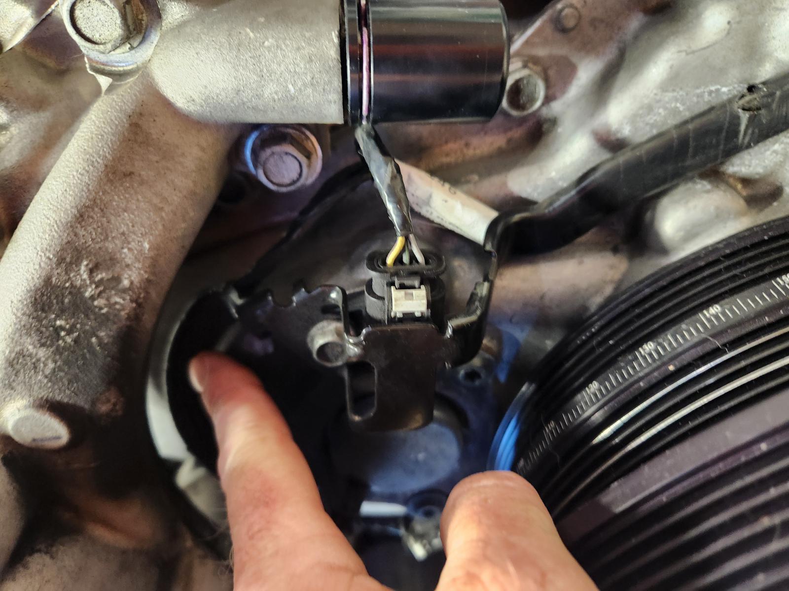

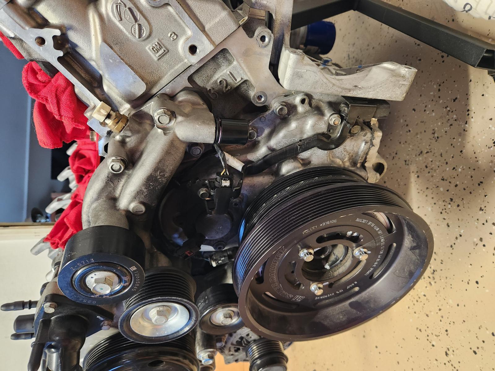

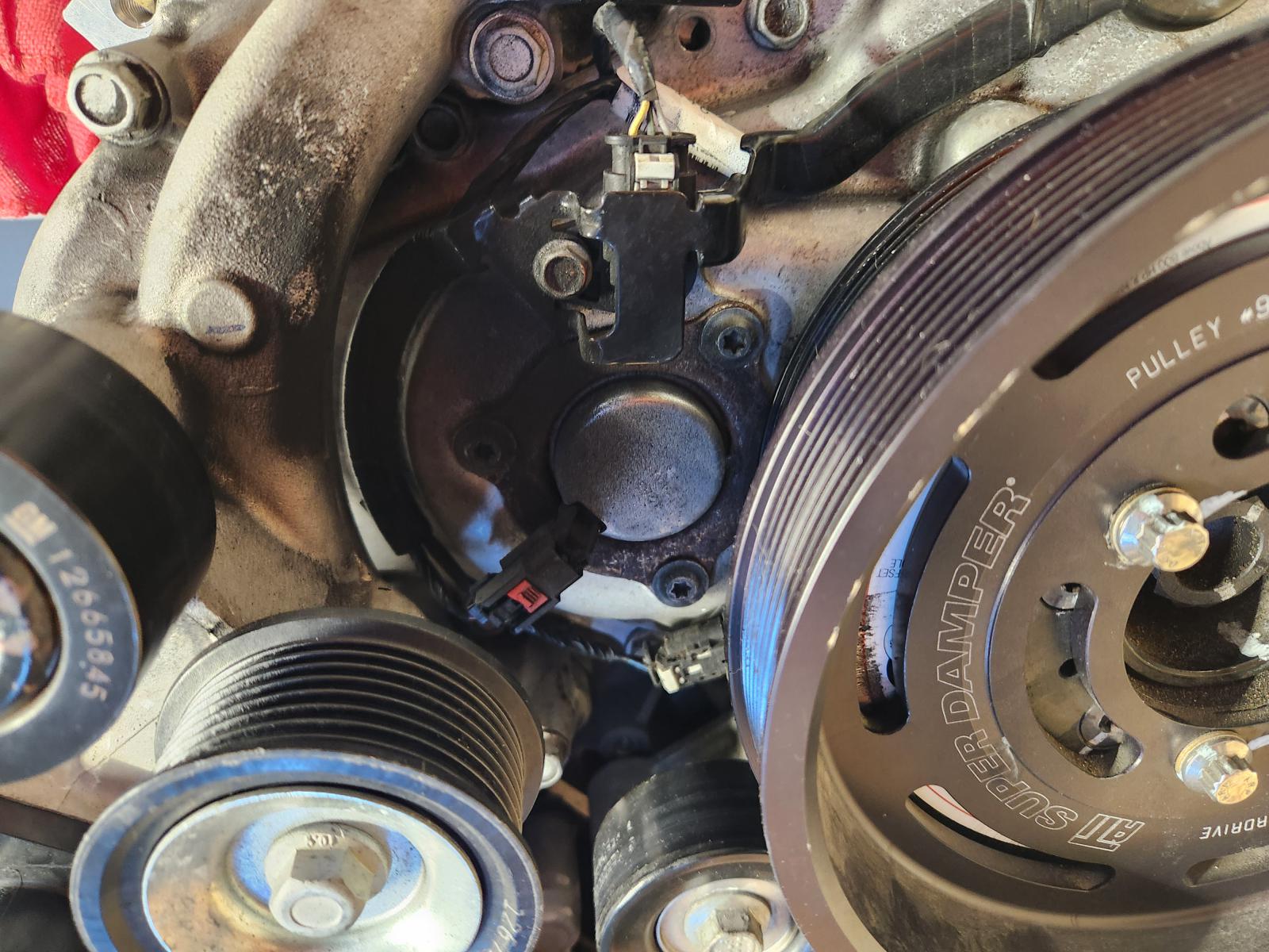

Thanks for that! Yea if you can send some pics when you have a moment it will be greatly appreciated. I will be swapping it with the engine still in the car so just seeing the complete picture of it outside the engine bay can help with reference. Just ordered my parts so will probably get to it when I get a day off. When the belt broke, it also somehow broke one of the coolant line Tee connector so I got to replace that as well. I know 2 of the 3 belt broke, I think the AC belt still on. I believe it was the supercharger belt and the belt to the alternator that broke.

Originally Posted by Ringmaster72 View Post
FUTURE1LE in regards to the harness......
I went through this last year. I had a belt issue destroy my harness and had a hard time finding the part. I used this part number: 12734111. If I remember there was slight difference but it worked without any wire changes. I think the "bracket" was slightly different. Here is the exact one I used. I also have the TSP DOD delete timing cover, so it is slightly different than stock and does need that plug.
https://www.ebay.com/itm/296886665875
Ring master, aside from the harness, was there anything I would need to buy? Cam phaser magnet?

Not sure if you can PM pictures, but if you can I wasn't able to figure it out. So I'll put them here. I'm pointing to where the wires are routed in the last one

This should help as well

Thank you for all the pictures and diagram! My parts are coming in so I will be replacing and getting the car back up and running.
