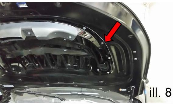

Not sure if it's in the area you are referring but when I installed mine 7 yrs ago they supplied a button head bolt to replace the hex head bolt in this location because of a clearance issue. Pic is from install instructions
Attachment 1157310
I ordered and installed mine ~ 1 year ago and mind also came with the extra bolts, and was also explicitly mentioned in the installation instructions. Using the supplied bolts there are no fitment issues.
I ended up removing it anyways since I don't drive the car in the rain and it will allow hot air to escape marginally better.
