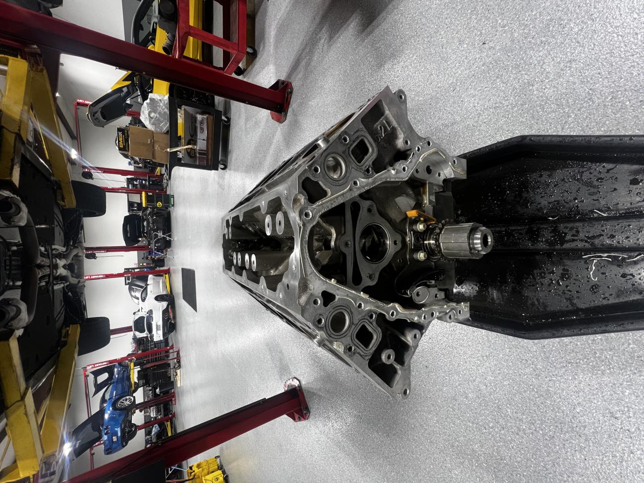

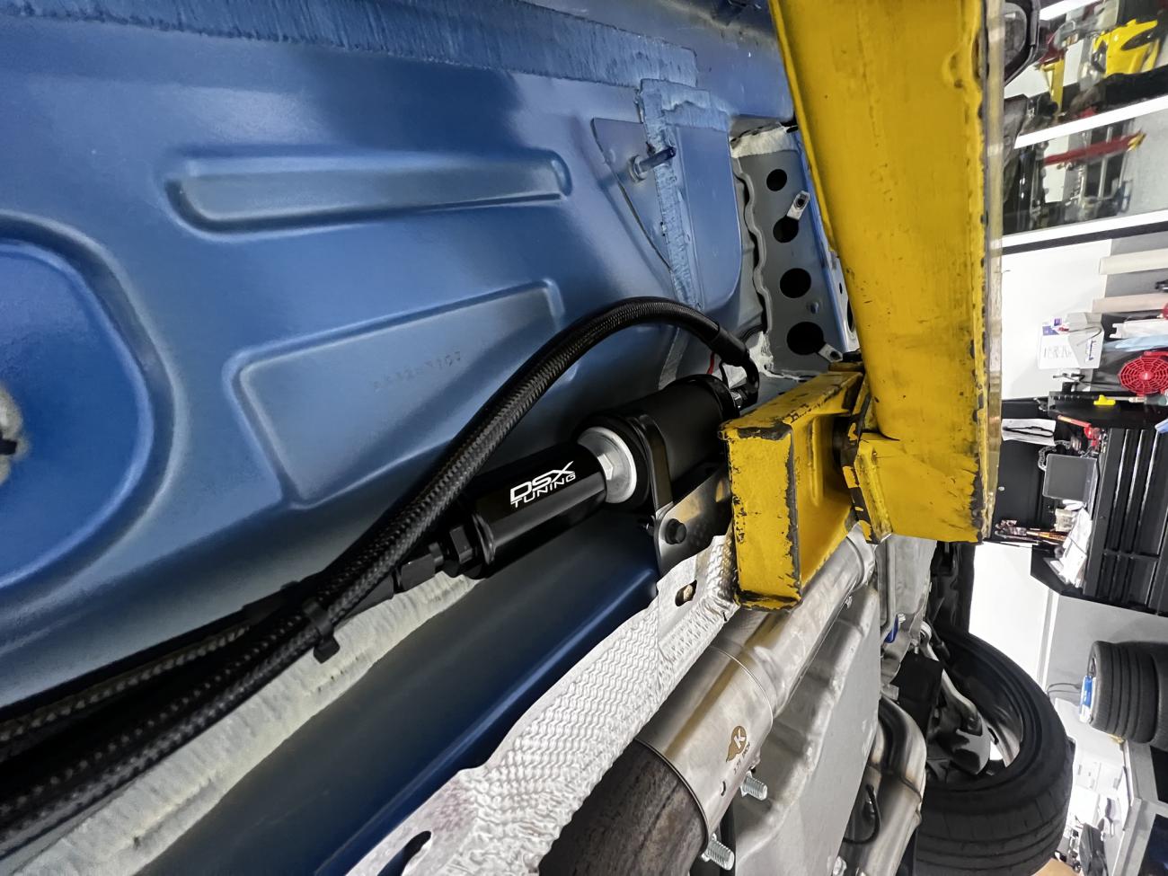

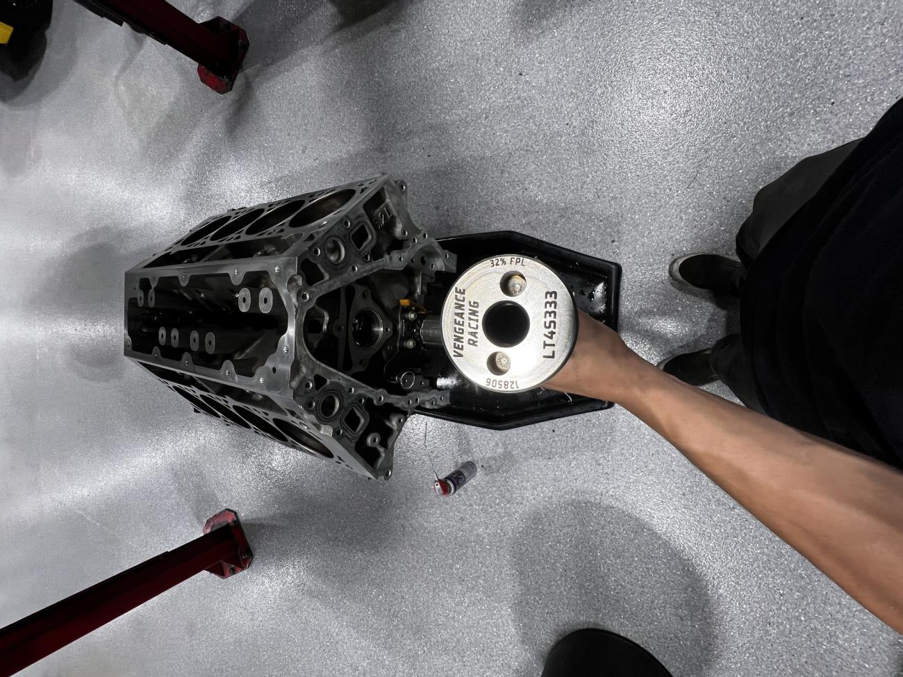

Alright, here goes. This is going to be a long post including all of the work I had done (in ordered listed on invoice), baseline dyno, final dyno, and my impressions:
Parts/fluids/misc:
1. Rotofab Big Gulp
2. Nick Williams 103MM TB
3. Kong CNC ported LT4 SC
4. Custom cam (32% fuel lobe) - stage 3
5. BTR .660" lift dual valve springs w/ titanium retainers
6. Vengeance racing 3/8" hardened push rods
7. IWIS pro series seamless roller timing chain
8. CHE high performance trunion kit
9. CompCams phaser lockout
10. GM VVT cam bolt, crank bolt, lifter trays, MLS 6.2 head gaskets, front cover seal
11. Johnson 2110R drop in lifters
12. DOD delete plug kit
13. ARP cylinder head bolt kit
14. Machined valley cover fuel pump mounting pad for HPFP preload
15. GM engine assembly sealant
16. ATI LT4 wet sump balancer kit
17. DSX tuning 9.45" lower pulley
18. Gates green 8 rib belt
19. ARH 2" LT headers, no cats, to stock NPP's
20. NGK LTR7IX plug set
21. Vengeance racing plug wire set
22. DSX 320lph aux fuel pump w/ CAN bus controller
23. Driven Racing 5W-40 oil
24. ACDelco oil filter
25. Dexcool coolant
26. 93 ECU tune
27. TCU unlock and tune
28. *Added later because I forgot* Katech billet oil pump
Now for the photo dump!

Photo set 1:
Nallek is offline   Reply With Quote

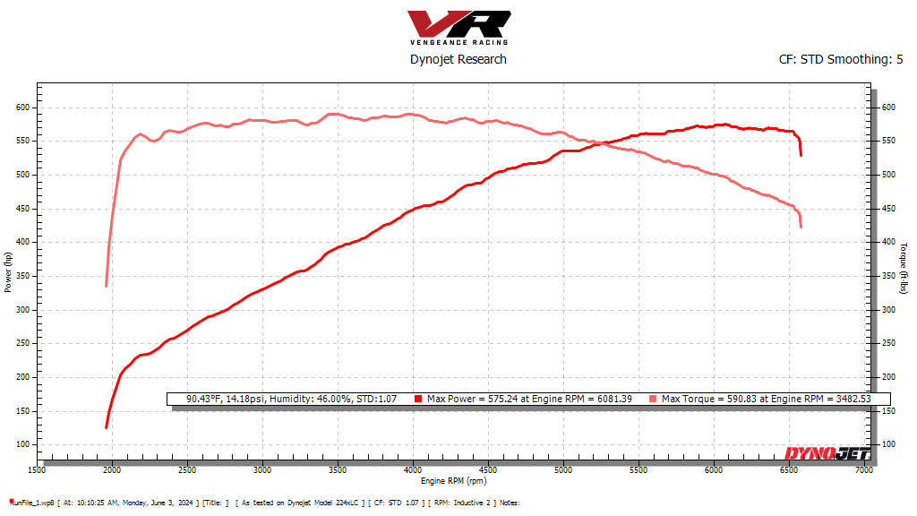

Baseline and final dyno's

Impressions: Vengeance is awesome. Excellent work, they keep you updated, reliable, car is a rocket ship. Every time I start it, I grin, smiles for days driving, listening to it, feeling it rock the car with the chop. 100% would do all this work again, plus I feel I've laid down some of the foundation to make big numbers later down the road.
What do you all think?

Congrats on the build. Enjoy it!
Also heads up... the top coolant tank needs to be full, not half empty (as shown in the last photo).

Yeah, it was a very last minute change i had them add, I forgot to snap a photo. Good eye!
I also checked the coolant and it was topped off, from previous comment. Thanks all!

Great numbers, great build. And if you desire down the road, add some e and pickup another 50-60whp, if not more.

I honestly feel like this is low, but maybe im wrong... maybe was tuned conservatively with things like timing, boost levels, etc IDK. You can defintely run e85 with your setup but I feel/think with your mods you should be atleast 750-780 range...
regardless, (to me) 700-750 is the sweet spot for this platform. What's important is what you describe... that you love it.
