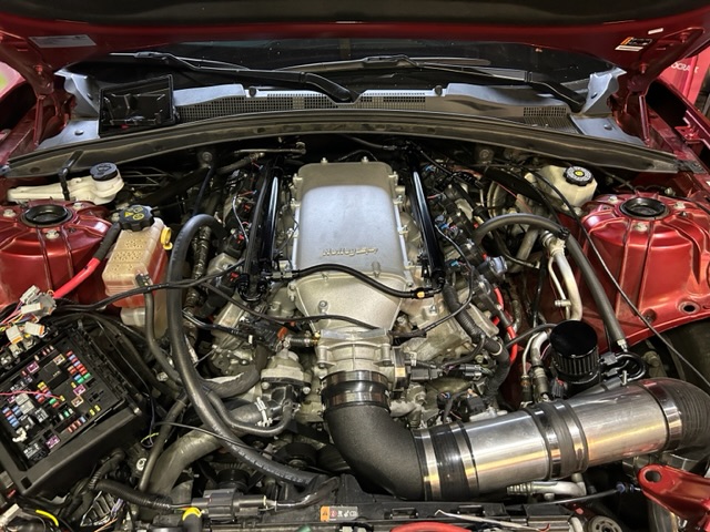

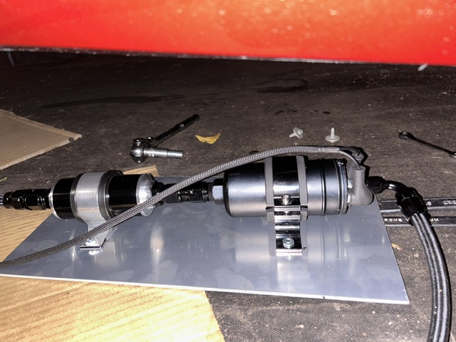

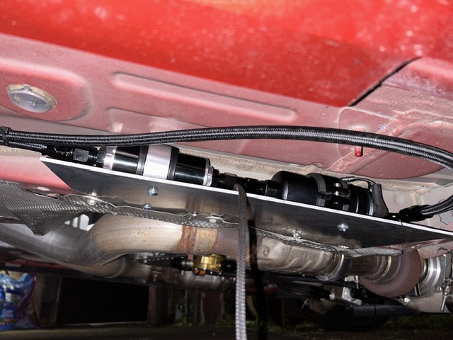

I didn't think anybody really cared but the engine is back together and the car is out. I did use the L8T crank in the oem block. The only clearancing i had to do was massage the oil squirters to clear the extra stroke. That wasn't too bad. I got my toohighpsi port injection on awhile back but this weekend finally added enough fuel pump to make use of it. I added an aem 400 aux pump being turned on by the motiv reflex controller. I also plan to use the built in boost controller on the controller as well. I'll add some pictures from my phone shortly.

Here’s a few recent pics. I can go into how I routed fuel lines for the pump and the port injection if anybody is interested.

Which Holley intake is that?

Rcoe it is a holley ultra lo intake manifold
