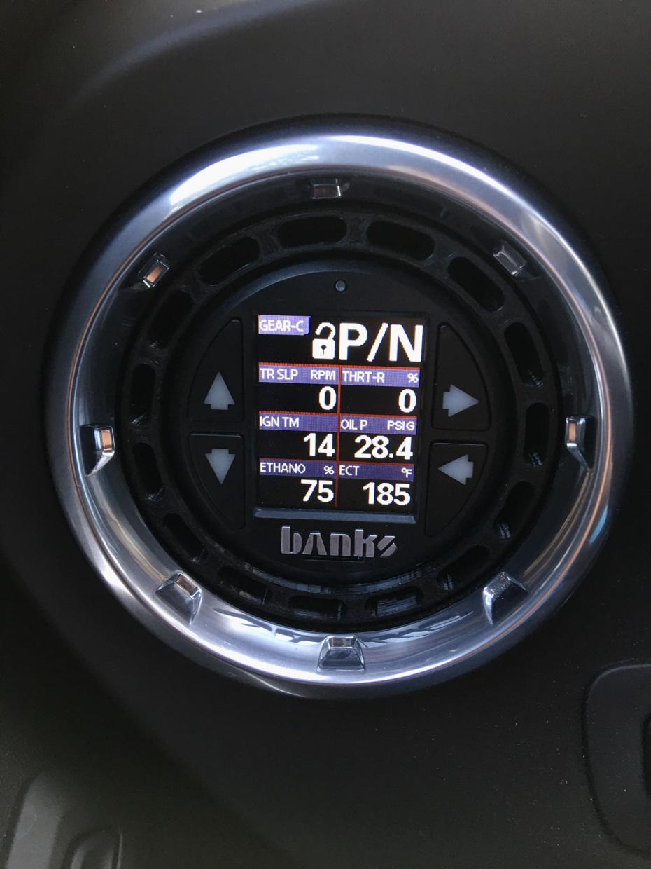

Yes. I exmained the entire lists of "BIDS" that Banks lists for the Camaro. No mention of gear. But you DO have "current gear selectable on the SuperGauge? I will go looking for it on the gauge itself!
Thanks for the alert!
Jim G
Yes sir Banks defines it as GEAR-C. No problem.

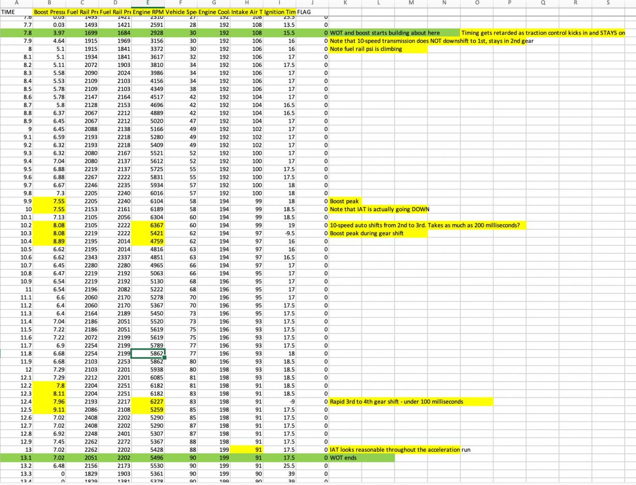

I got the BanksiDash programmed correctly for my needs, and did an acceleration run from 30mph to 90 mph, datalogging the entire run (bracketed cleanly by speeds below and above)
Keep in mind that this run was done at a location whose elevation is unknown, but is on a route between locations with elevations of 3000 feet and 3557 feet, so it is at a high elevation, and I am not sure how that affects the boost psi. You'll need someone more knowledgeable than me to comment on that.
But that log is shown below.
Note that the peak boost, BEFORE the 10-speed's automatic gearshift, runs about 7.55 to 7.8 psi, and then flares upward to 8.08 to 9.11 psi during the shift, presumably because during the shift the engine is decelerating to a lower rpm, and thus is not capable of accepting the air at its pre-shift rate?

Originally Posted by JimGnitecki View Post
I don't do videos accelerating hard from a dead stop (too hard on the drivetrain), or when accelerating hard in a car that is using traction control all the way to highway speeds, and doing its best to outmanoeuvre the traction control and stability control nannys! But I can do better:
Jim G
All I wanted to see is the gauge set on boost should be neg number at idle, then just make a hit in 5th or 6th gear and let me see the neg go to positive.
I have the banks on 2 of my cars the zl1 which comes with a blower works perfectly the SS can't read boost because either the way the break out harness is or the gauge can only read the oem MAP sensor and other map sensor it will not display correctly.
I'd like to see you actually go from neg to positive in the boost setting if so I will replace my map with like you have instead of the one provided by edelbrock and get the tuner to change some things.
In examing my datalog OUTSIDE the WOT portion, I see that it NEVER reports vacuum versus boost. It just always shows "0" when no boost. And, I do not recall ever seeing a negative value for the boost psi when driving with the iDash DataMonster displaying. I think this is because the Banks iDash and DataMonster reply entirely on the OEM OBDI outputs, plus some calculated values that Banks does automatically using those OEM data points. I think you might need a separate pressure transmitter daisychained into the Banks databus, which is supposedly easy to do. You might ask Banks.

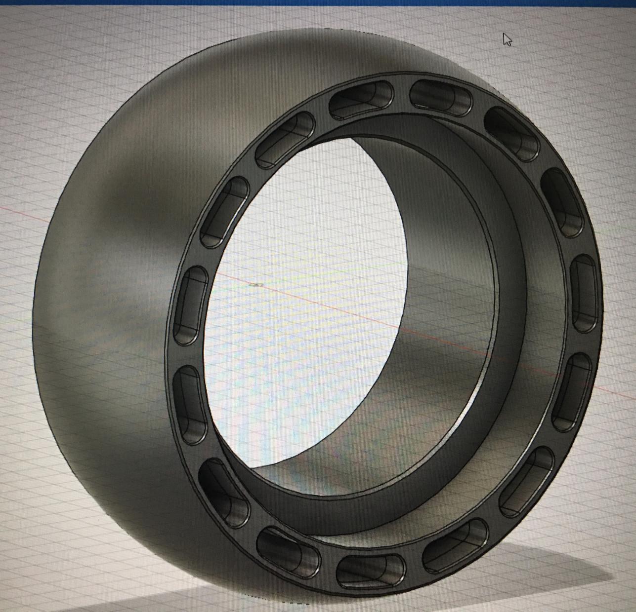

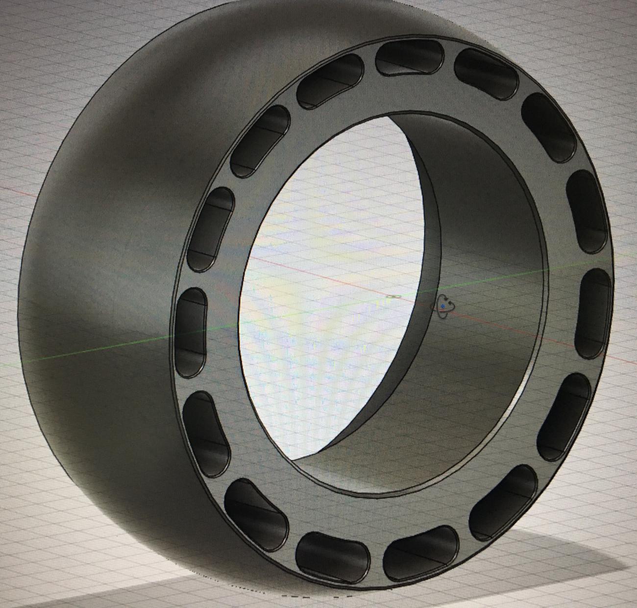

I like your setup and you still have the Vent working also.
Thanks! The vent still works and here is the front and back view. I did put a 4° draft angle on the slots to increase velocity. The air flow is less with the gauge. I don’t recall the exact CFM difference between the driver vent and passenger vent after install. I want to say it was a 40% loss.
