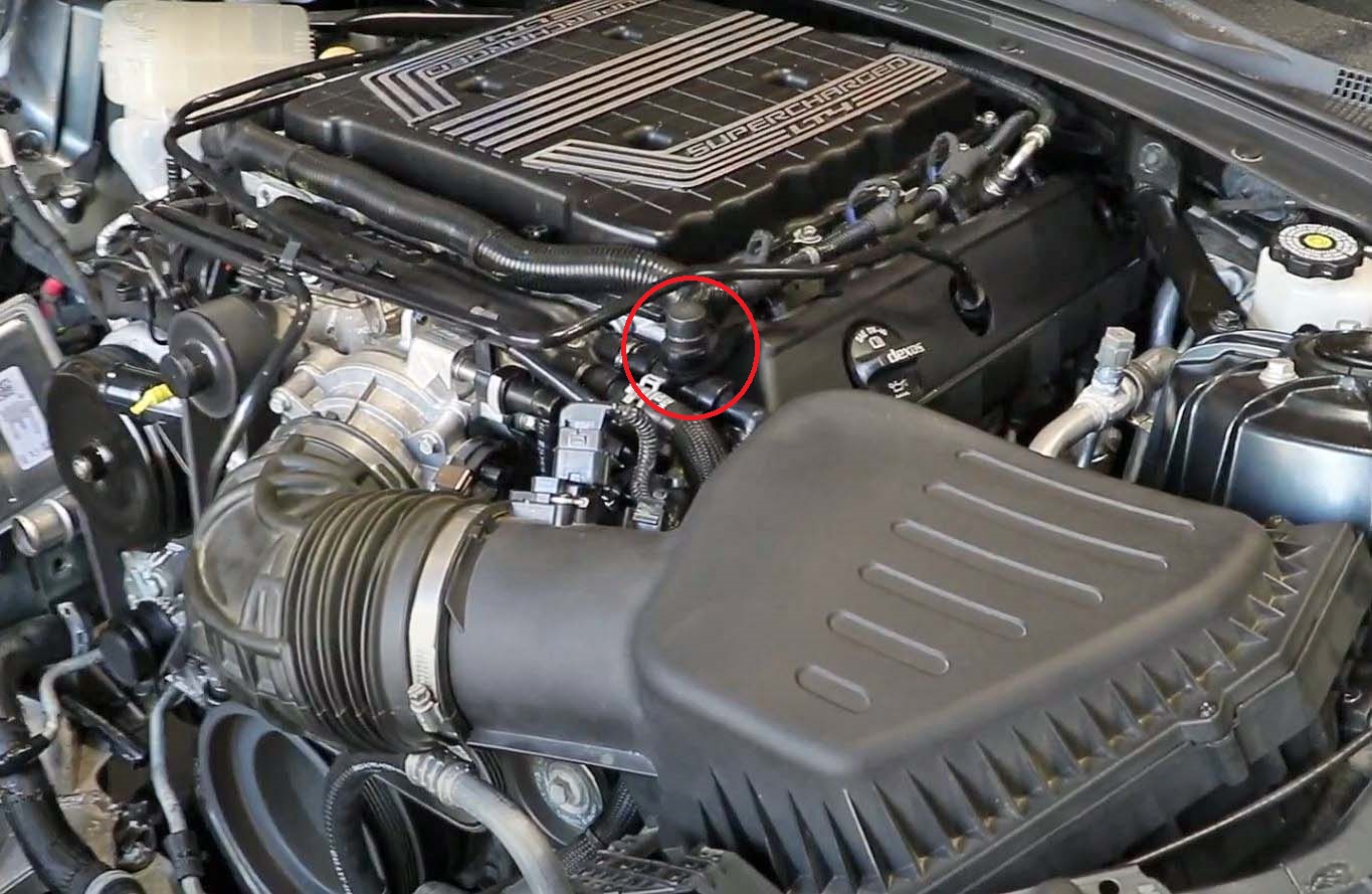

Originally Posted by gtfoxy View Post
What other addition components, or fittings, do our ZL1’s require that don’t come in the base kit?
The LT4 in the ZL1 varies a little. The VAST majority of them use just the Series 5 adapter to connect the main bleeder kit to the vehicle. The Series 5 adapter is a replacement for GM tool GE-47716-30a , including the shorter depressor valve. If the Series 5 adapter is needed, your bleeding port will look like this:
https://static.wixstatic.com/media/b...5b2cf2~mv2.jpg

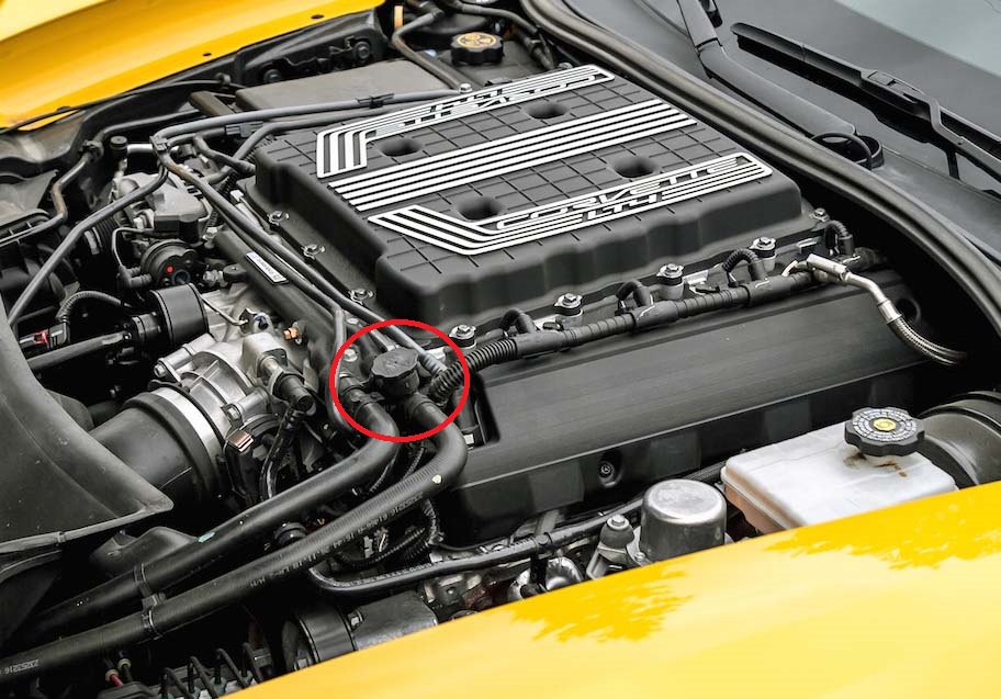

However, there was a service bulletin published by GM that instructed the dealers to convert the ZL1 to the Corvette style bleeding port before they had tooling available to bleed the other port style. If this was done to your car, the bleeder port was retrofitted to the Corvette Style, then you would use the Series 2 adapter and QC1 plug instead. This style is a flower shaped cap, like this:
https://static.wixstatic.com/media/b...4be939~mv2.jpg
I do also have a large assortment of other adapter styles and fittings if you have modified away from the factory style fittings.
