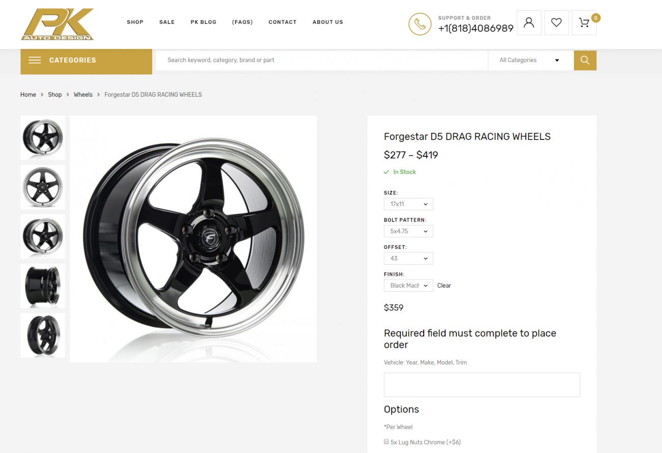

Awesome! I'm not glued to the Welds just wanted something that would hold up without issues. Do you happen to know the bolt pattern and offsets for 17x11 on the ZL1? Just wanted to make sure the ones below would work.
My APEX wheels have the same ET43 rear offset so that looks good but the bolt pattern I am not sure about. APEX wheels for the Camaros are 5x120mm, but the Forgestar is 5x4.75. Converting 120mm to inches is 4.72 and change which seems close but not 100% sure thats close enough. The center bore I cant see specs on to verify, but it should be 67.1mm I believe.

Possibly these? Center bore is notably bigger than 67.1 though and again the bolt pattern is a bit off.
https://www.summitracing.com/parts/wld-71hb7110b77a

Give Paul a shout at PK Auto, he’s the Forgestar dealer and is awesome at answering all the technical questions.
