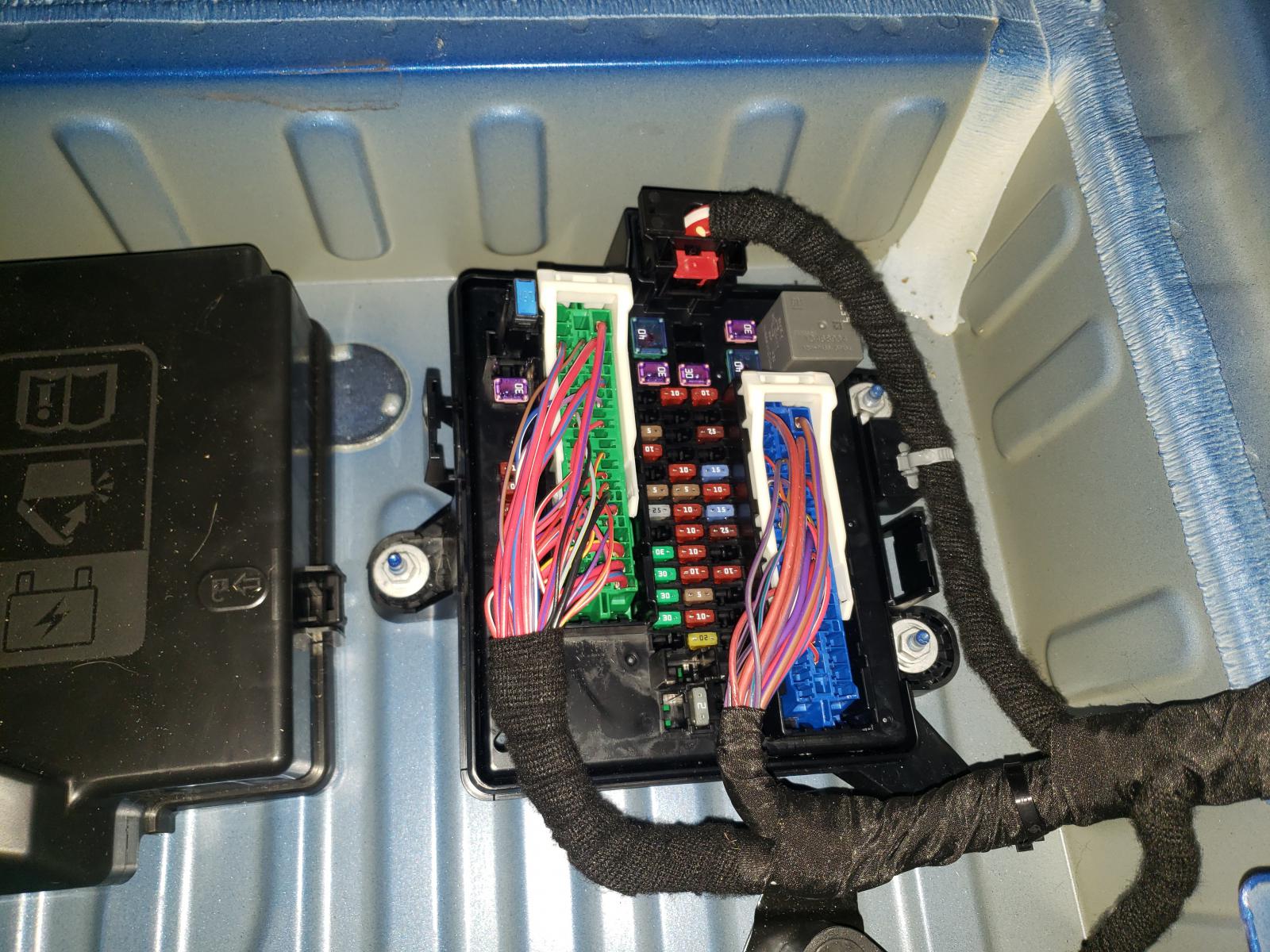

Unfortunately I looked up the parts from mouser and only 1 is in stock. Does it call for a splice to that wire, or is it rerouted through the jms? Will be installing soon and find this thread very helpful. Thanks

I followed the 12v wire going to the fscm connector back to the fuse block in the trunk. Is it not possible to intercept the wire coming out of the fuse block rather than having to run a wire out of the vehicle to the connector? Just wondering if this will work, would seem to make install much cleaner and easier for me

So looks like the zl1 is different than the ss. The chassis control module isn't located in the same spot but think it sits next the the fuse block on the right side of the trunk. Still trying to figure it out. Plenty of writeups just trying to find the right one
Thanks for any input
Yes is it possible but not recommended, as the wire size is too small to carry the additional current to the control module
We recommend connection within 2 inches of control module.
ZL-1 and 1LE are above the axle under the car.

Thanks Ted, I was hoping to just run it off the fuse block but it makes sense that the factory wire is too small to run the current.
How about using a sealed one wire connector to splice the wires at the control module? Just make sure the connector is rated for 30a? Thanks
How about follow my instructions and you wont' get in trouble.

I'll follow what you've said and splice it 2" from the connector under the car. Can't find the right pin to run the jms into the connector, so instead of butt connectors was trying to get away with a weatherproof oem style one wire connector to splice the wires.

since you are wiring inside the car normal butt connectors are all that is needed.
If you want to get fancy you can use Shrink Butt Connectors
Or install blade connectors so you can bypass it quickly if ever needed.
We simply want to intercept system voltage feed, run it through the JMS then on to the FSCM.
