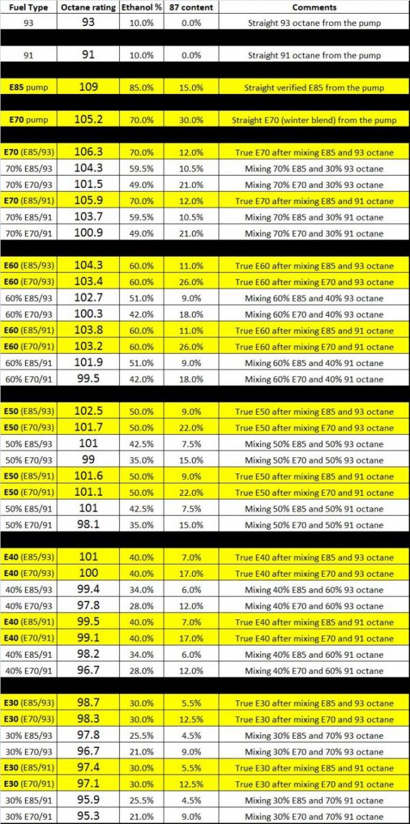

Here is a good chart for reference far as mixing E85 and it's octane equivalency.

I agree he won't be able to run 11 psi on full E85 without a cam or meth. However like I said before you don't really need to, E60 is 104octane.
