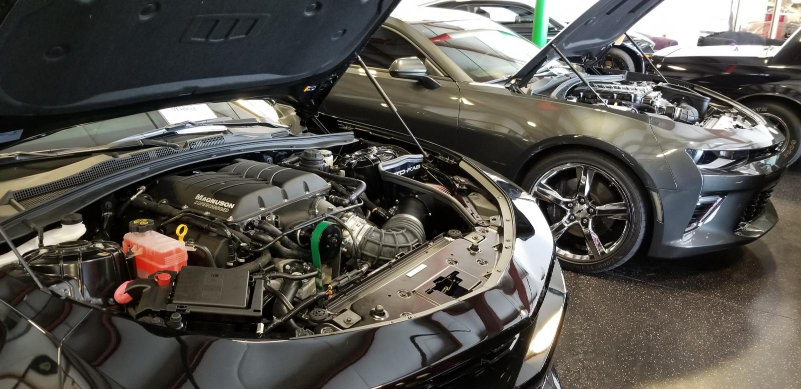

Here is a pic of a 2019 SS A10 that received a Maggie next to my car.
