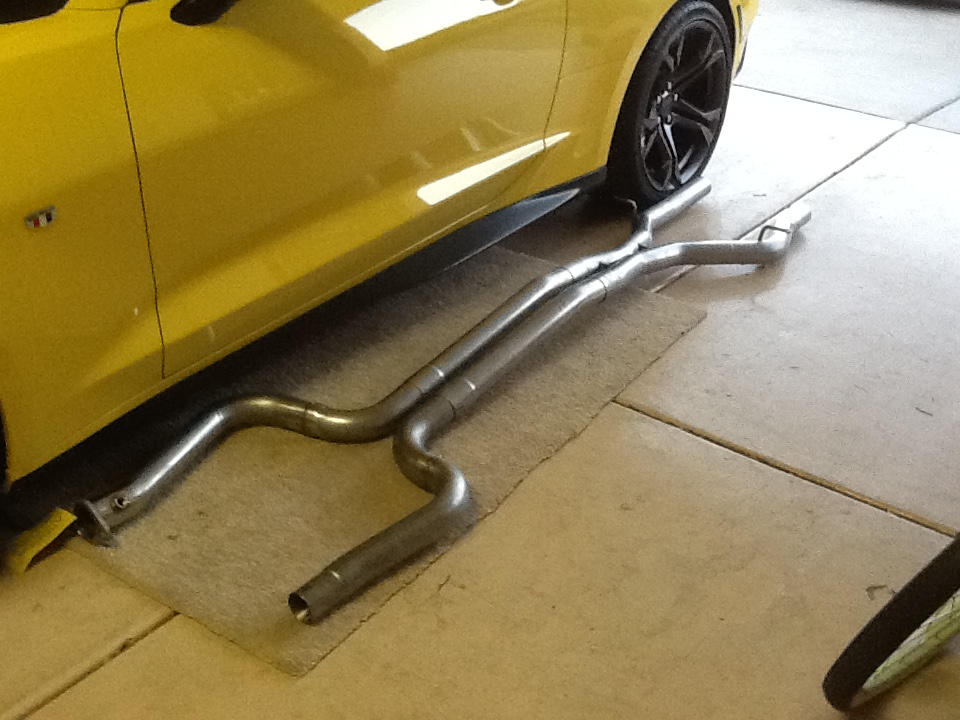

I have a 3 inch flowmaster xpipe would the 60606 bolt up to that?
the borla 60606 and Flowmaster x pipe are both mid pipes...
you mean you have the flowmaster axle back?

oh my mistake i was referring to the borla secondary cat delete only section. I mixed up this number with the 60626.
No worries, I have studied this setup as I am split between the Stainless Works full cat back or the 60626 (or the 60663, which is 2.75") connecting to the FLowmaster X pipe and their NPP axle back.
I have found that it can work but you will have to cut some of the Borla pipe in order to work
thats the setup I have. I have their xpipe and npp exhaust. I recently had the secondary cats removed but the pipes they installed are leaking now and I rather just install the 60626 and not deal with it. When it wasnt leaking at first it sound awesome I am glad I did it.
Mine were leaking too when I removed the secondary cats and I put a generous amount of Permatex Muffler & Tailpipe Sealer all around the welds. It's a temp fix until I figure out which way to go.

unfort I dont and now it sounds different due to the leak. I will be ordering the 60626 later in the week and will install that once it arrives.

You're hijacking my thread. All good...how about those clamps for mating the 60606 and suitcase? Think this likely temp setup. Suspect I'll put a magnaflow comp series axle back on.
Vibrant clamps will do the trick

Probably be 3 weeks before I get around to install. Conflicts. Going to clamp then see from there. Magnaflow is 3" so the pipes will slide in and clamp up if I chose that route. Need to find the clamps. Search turns up too many returns.
