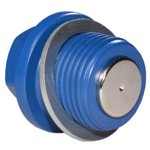

Engine Oil Drain Plug
LT4/LT1 (probably more)
M12x1.75x21
Rear Differential
2012-2018 Camaro ZL1 & Z06
M20x1.5x14

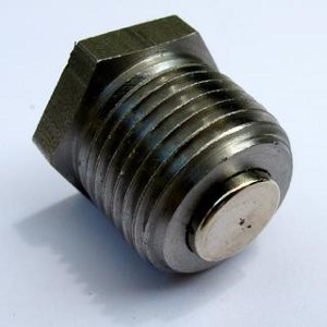

Manual Transmission
TR6060 & T56 in 2012-2018 Camaro & Z06
NPT 1/2"
M12x1.75x21
Attachment 928457
Rear Differential
M20x1.5x14
Attachment 928458
Manual Transmission
NPT 1/2"
Attachment 928459
