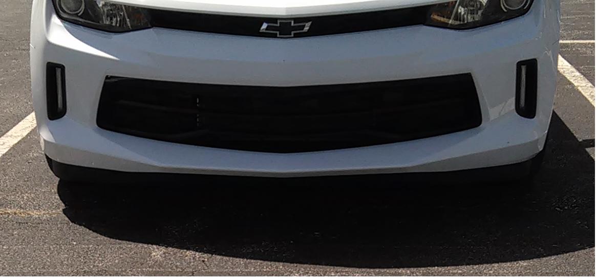

Hey bud. The grill I ordered is actually from GM. I ordered it in black, but you can order it with color matching inserts pre painted also. It comes with both upper and lower grills, and you do have to attach your emblem along with some other assembly. It comes with all the necessary brackets, so its no biggie. Im actually glad it came that way, because I left the emblem removed until I decide if I like it or not. Also, GM's list price on this grill kit (upper and lower together) is 595$. I only payed about 400$ for mine, but you should be able to find it readily for 500$. I will get some pictures up today of how it looks installed on my car. Maybe get some opinions on the emblem. (on or off)
Flex Fuel tuned by me using HPT-:-
---My Build Thread---
-----My IG PAGe-----
Old 03-12-2018, 01:15 PM   #18
cooper1965
Coopers Camaro
cooper1965's Avatar
Drives: 18 Flex Fuel LTG
Posts: 934
Not the best picture, I can get more if someone needs them. This was not a bad install, I made it more difficult because I wasn't happy with some of the factory fitment, but all in all, Im very happy with how it all worked out. Looks years better to my eyes!

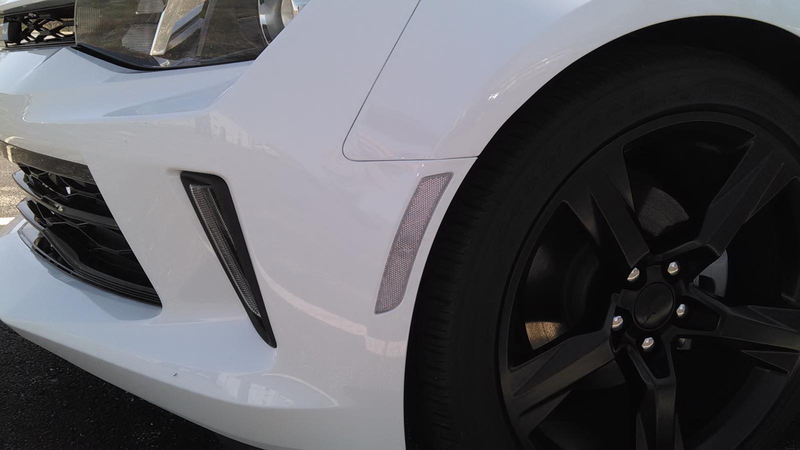

Managed to get a couple small things done recently. I added the black bowtie from GM to the upper grill by suggestion. I think it helps the symmetry of the front end. Also added front and rear GM Clear side markers. These are super cheap, like 8$ a piece straight from GM. Gm part # 23169179 x2 & 23169180 x2. They are european spec, and will have to be modified to accept your factory sockets. The process was super easy and quick with a dremel and a steady hand. The factory bulbs had a yellowish tint, so I replaced them with Hp3 led replacement bulbs from Bigwormgraphics. All 4 bulbs cost $34.45 after shipping. Very pleased with the look, fit and color of the lamp/bulb combo now. Its a perfect match to the front factory led DRL strips as far as bulb color, and the clear lenses look great on the white. Here is a few pics of what I'm talking about, and some finished product shots.

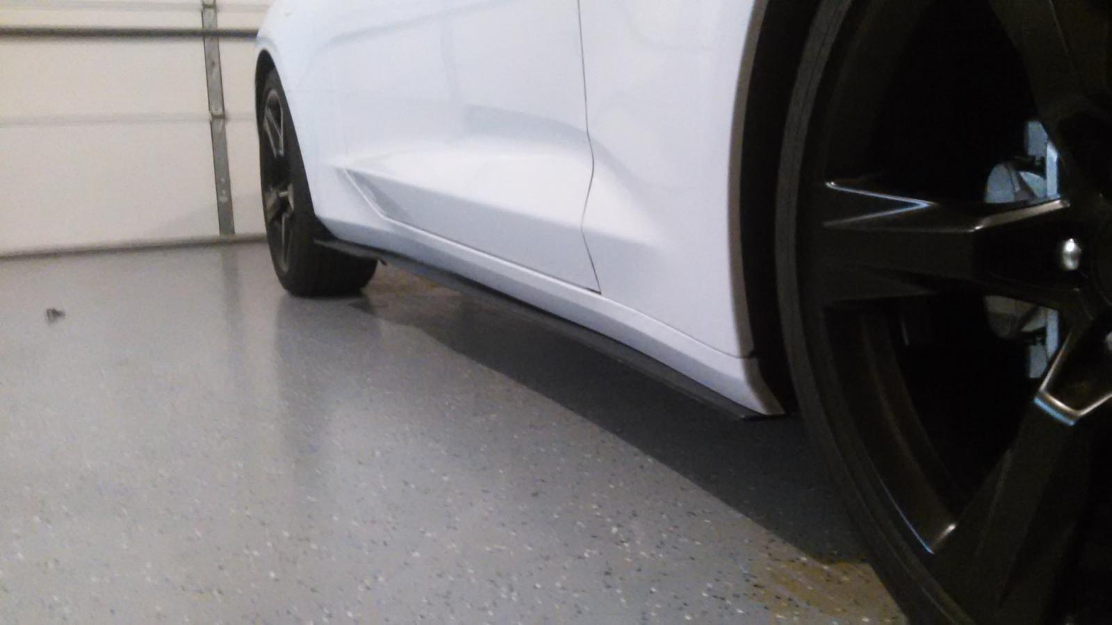

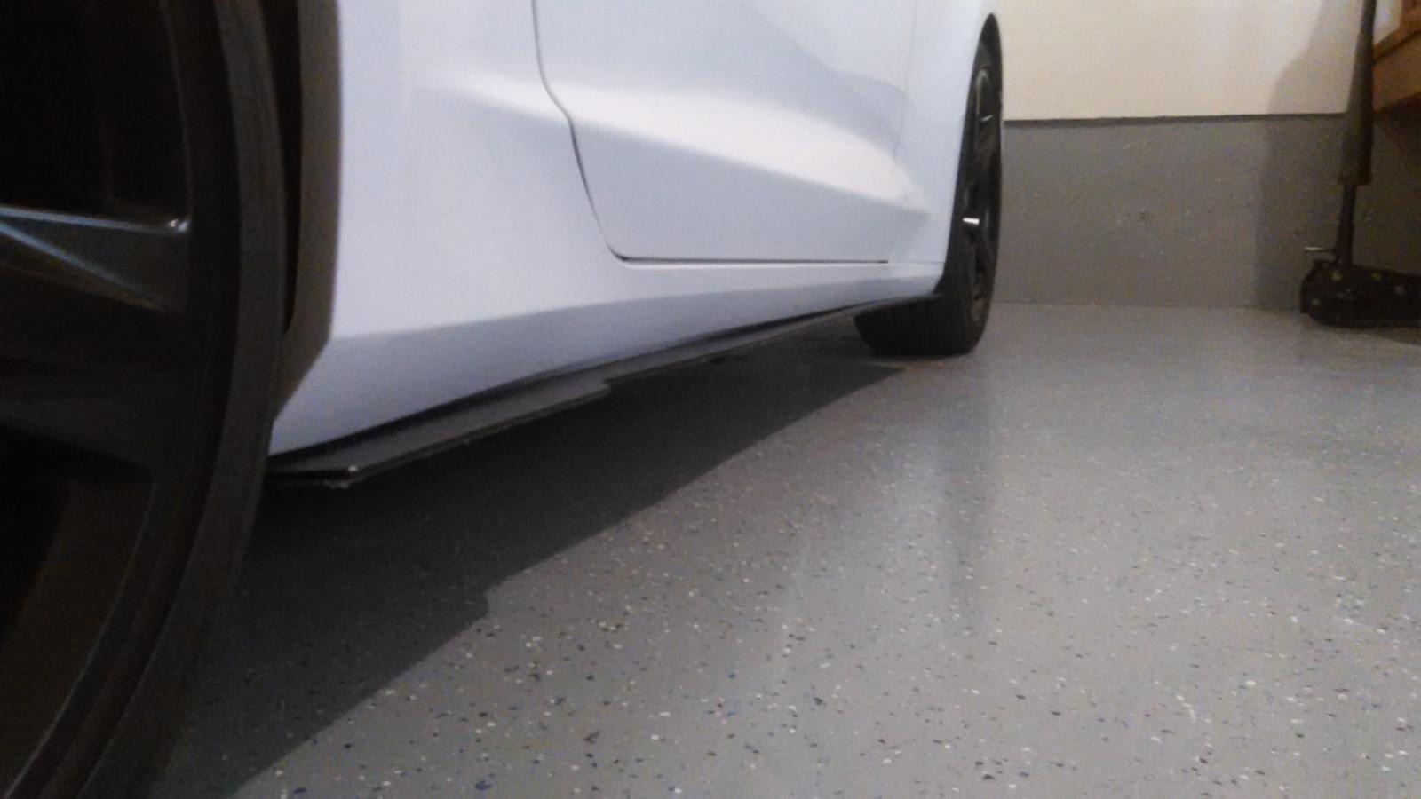

Started trimming and test fitting some side splitters. I will be doing a rear splitter as well, still kinda on the fence about a front splitter. I like how non intrusive these look so far, but I want them tucked a bit more.

I just realized after posting in another thread, I skipped over a few lighting details, and a lit-up pick. These are the headlight bulbs, and side markers I used to try and match the factory DRL led strips. Installing the headlight bulbs was a bit tight, but I went through the wheel wells after removing just 3 T15 screws. Same with the side markers. Did not need to remove the wheels or the bumper.
