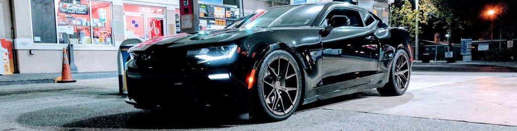

Your car looks great. Mine pokes out but BARELY any.
