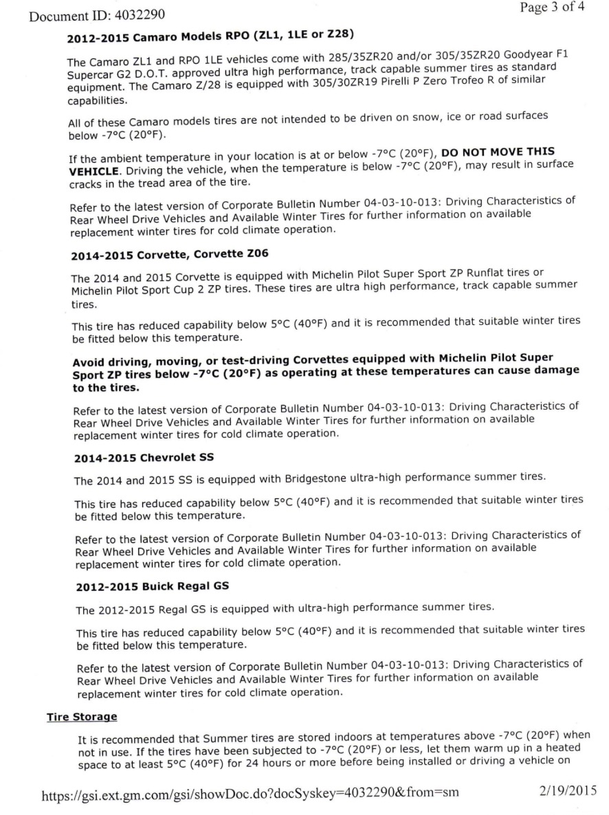

"Over hyped"??? I guess you can take your chances, but there is plenty of evidence of these type of tire compounds cracking at low temps. Roll at your own risk...
http://gmauthority.com/blog/2015/03/...cracked-tires/
https://www.svtperformance.com/forum...eather.814268/
http://www.consumerreports.org/cro/n...king/index.htm

I never said the rubber won't crack. However, the way it's being portrayed by some is that in cold temperatures these tires will automatically shatter into millions of pieces.
I'm on my second ZL1 and thus my second set of Goodyear F1 Supercar tires. I've been on the Camaro 5 & 6 forums for six years. I've seen few, if any, complaints of these tires cracking in cold temps. And I'm going to make an educated guess that some cars have even been driven in temps below 20 degrees.
All I'm saying is the rubber isn't as brittle in the cold as the reports would have you believe. Can the rubber crack? Sure it can. But if you use some common sense, the likelihood of cracking is pretty low.
BTW, the PBS bulletin from the second link in your post was updated in Feb 2015. It removed the "Do not drive below 40 degrees recommendation".

I'm not going to argue over this. The OP asked if it was a concern. Yes. Is it guaranteed that it will cause your tires to crack? No. However, it must be enough of a concern that GM felt it necessary to write it directly into the Owner's Manual:
"High Performance Summer Tires
See the HP Supplement.
This vehicle may come with 245/ 40ZR20 and 275/35ZR20 high
performance summer tires. These tires have a special tread and compound that are optimized for
maximum dry and wet road performance. This special tread and compound will have decreased performance in cold climates, and
on ice and snow. It is recommended that winter tires be installed on the vehicle if frequent driving at temperatures below approximately
5°C (40°F) or on ice or snow covered roads is expected.
See Winter Tires 0 293."
Specifically in the HP supplement it states: "...may develop surface cracks in the tread area at temperatures below -7 C (20 F)".
So again, if you want to take the risk by all means. But don't complain if you have to eat the cost of a new set of tires.
