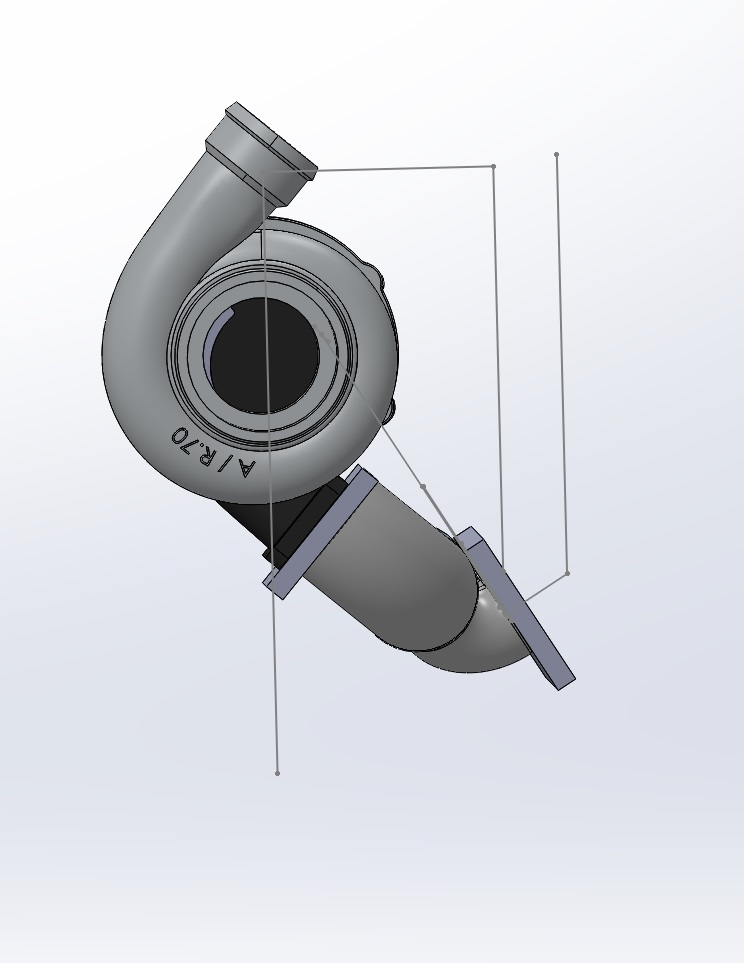

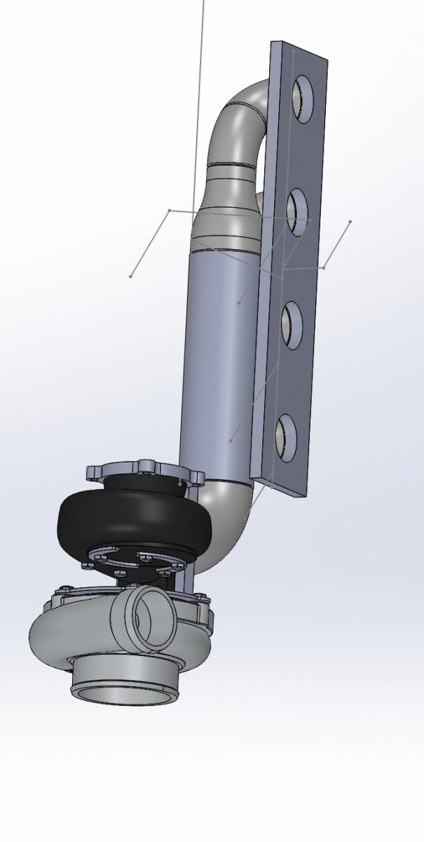

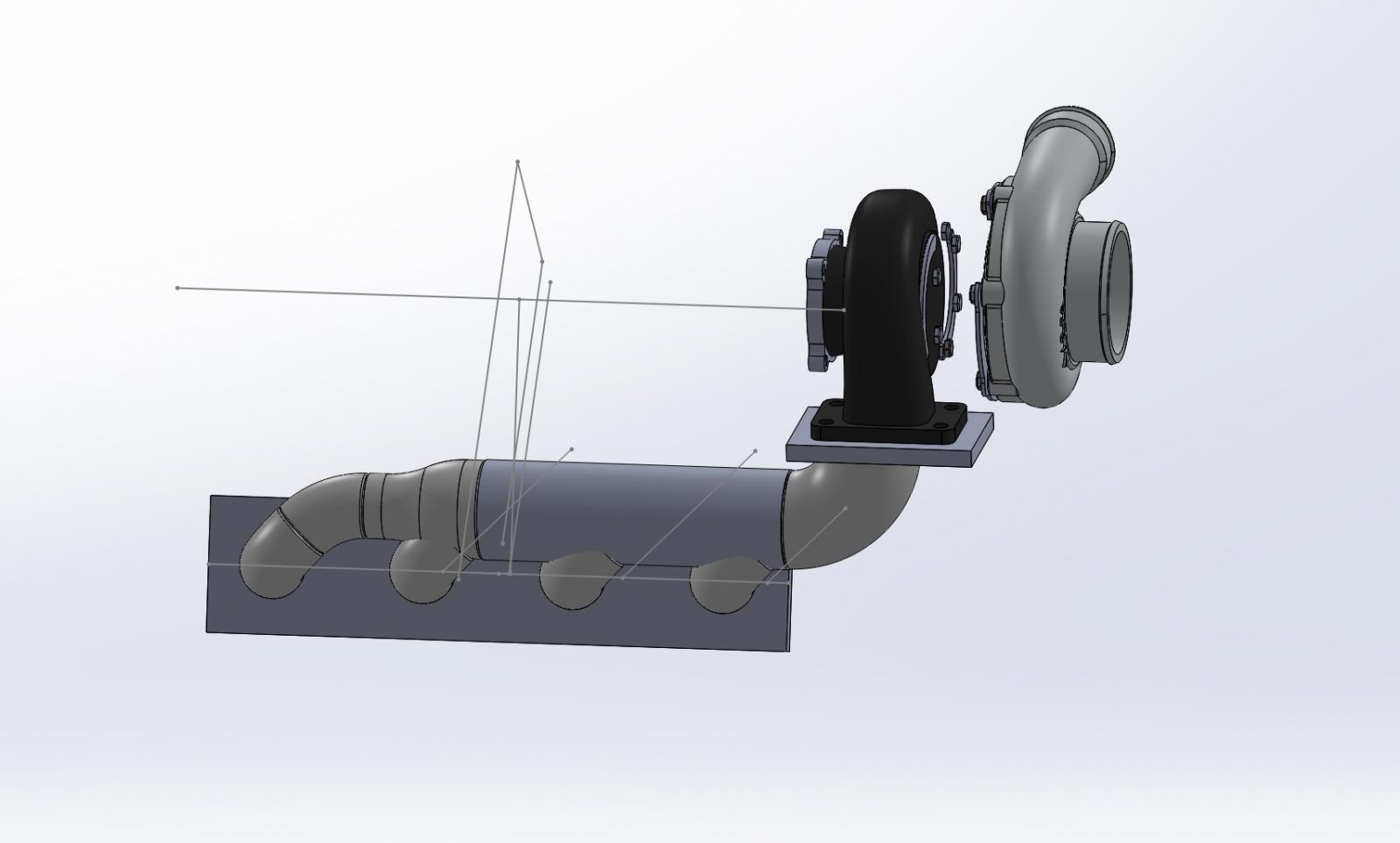

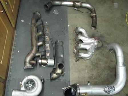

concept work on left turbo manifold based on measurements I took today to shock tower etc.
May need to move the turbo another inch or two forward but I think it is about on point with clearing the water pump shock tower etc.
The dp will have to be ovaled to go between the left frame rail and the turbo manifold but not by much.
Should clear the hood, if there is any interference it will be likely 1-2" max so just the hump of the snail might protrude not the entire filter inlet or anything else.... (a copo hood would clear but personally if its peeking out on mine I'm fine with that)
Just need to angle the fuse box behind the headlight down however Armageddon did theirs, I haven't bothered bringing out a wrench to see yet.
Also will build new heater lines and a new water overflow/fill tank.
The drivers side will be much easier, might not need to mod the ac lines any, just bend the heck out of the bracket that holds them to the shock tower so they get closer to the tower....
Just waiting on delivery of my mockup engine now so I can start building

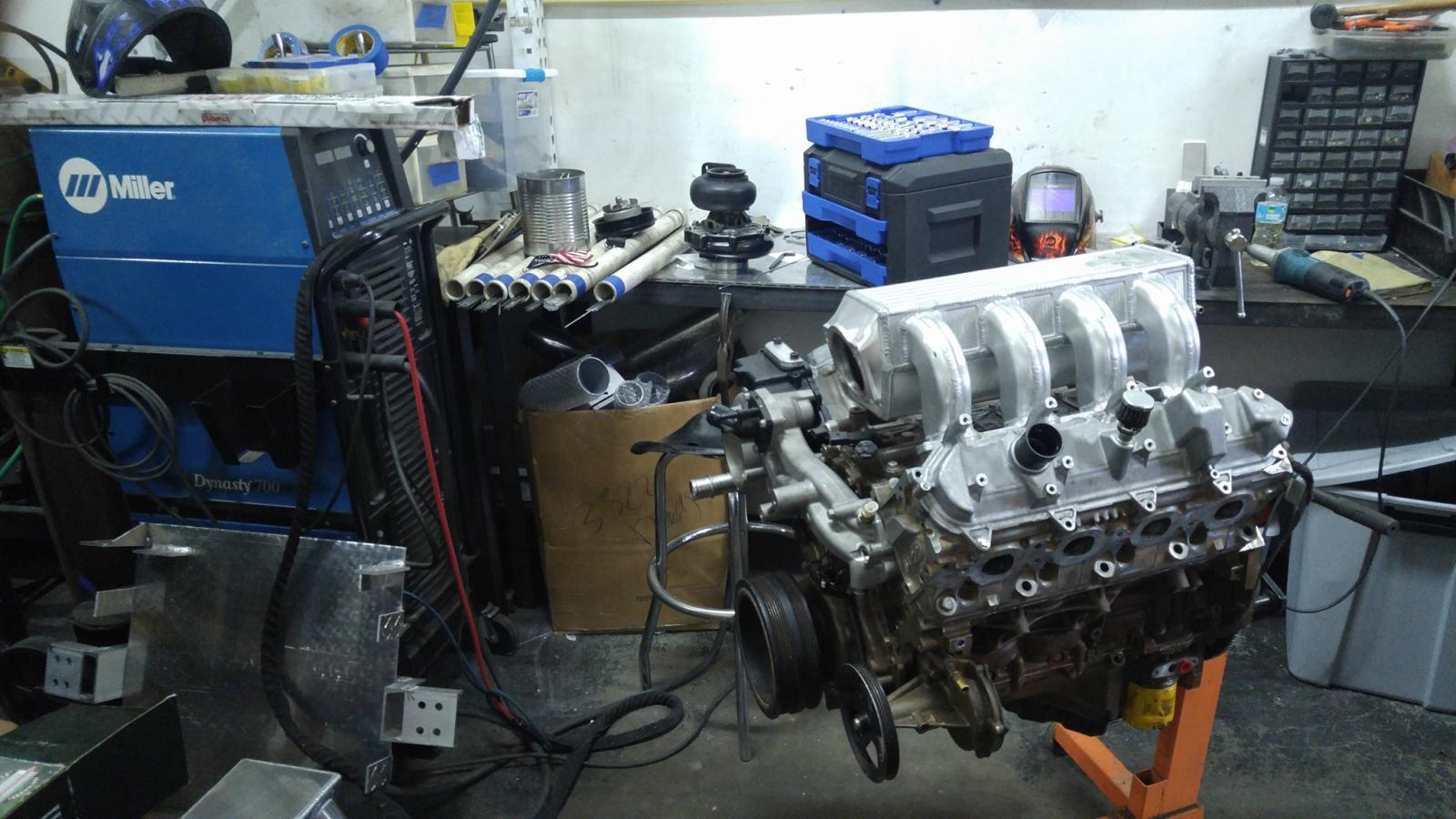

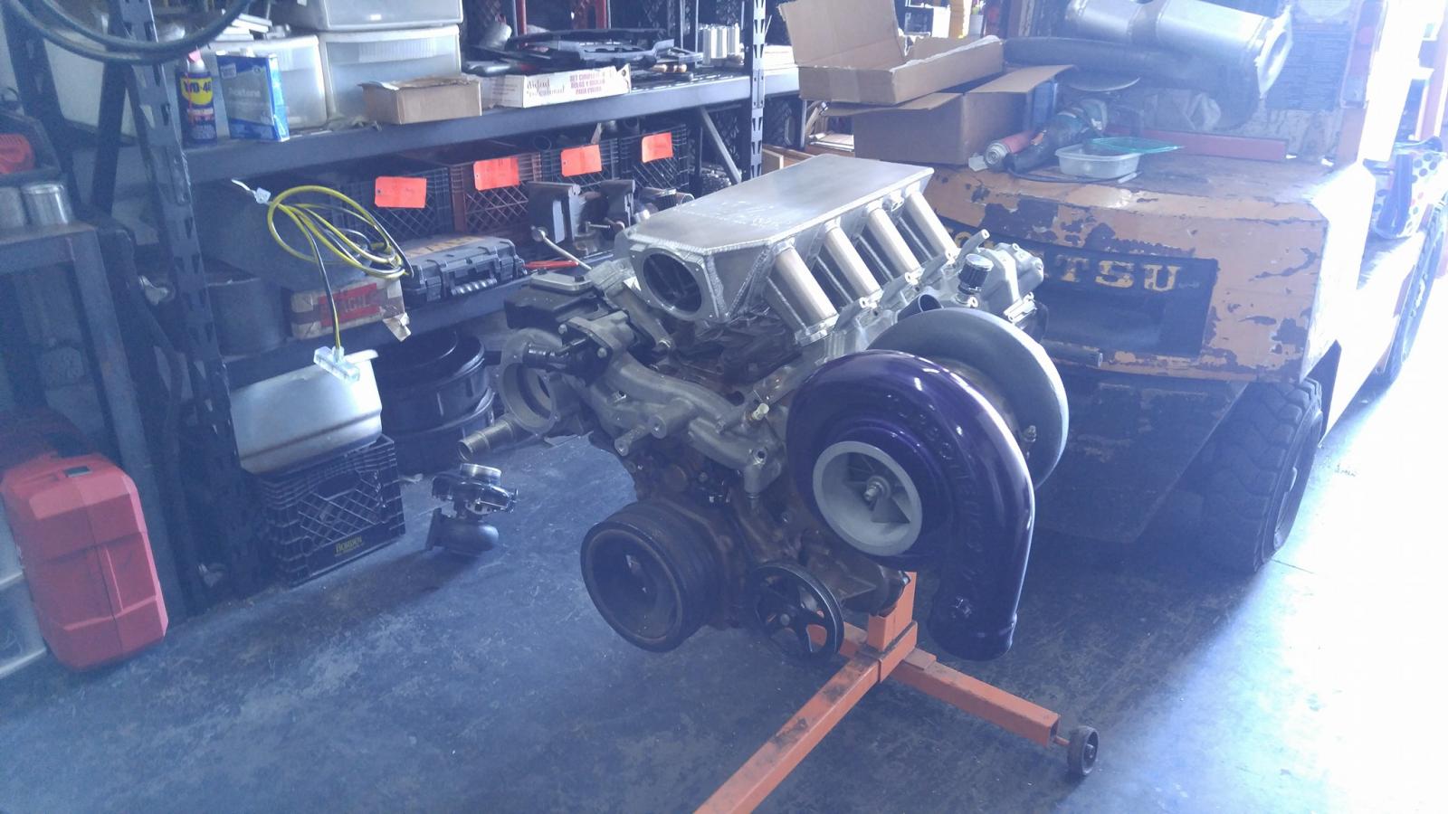

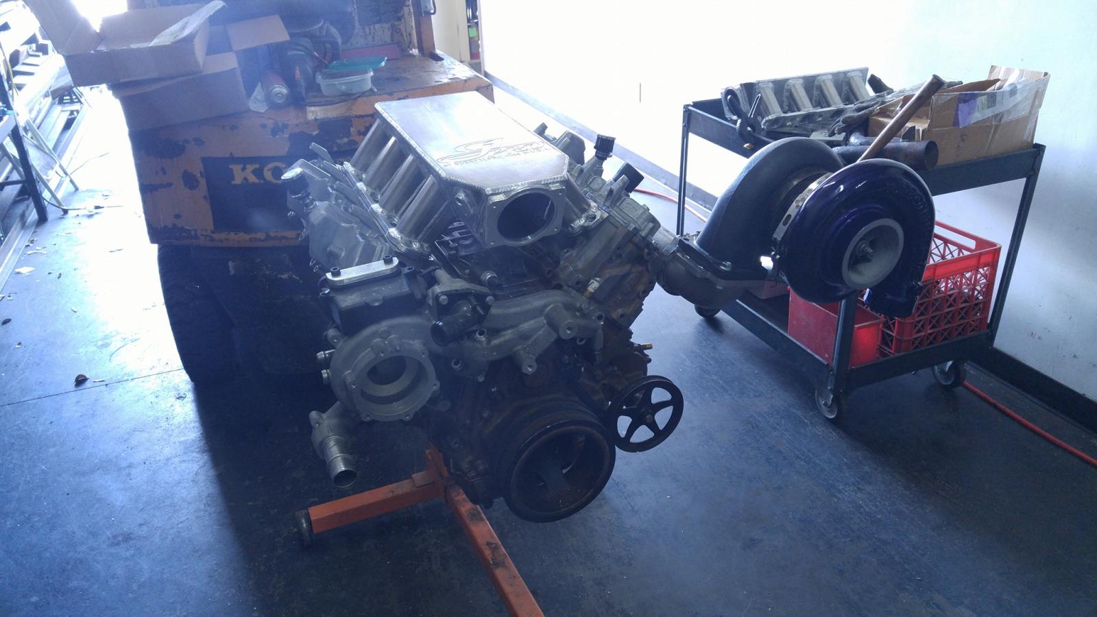

Mockup engine setup and mockup turbo the table ready to start fabbing
Gonna get my materials in next week for the new turbo manifolds.
For all the other fab monkeys out there, yes that is a Dynasty 700

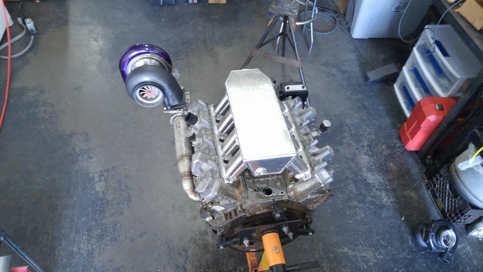

Started the new turbo manifold, I'll post pics tomorrow when I should have the driver side finished.
Decided on single turbo topmount driver side
Using a t6 turbonetics 91mm y2k turbo for mockup but will be using a big borg warner for the car.
Building the manifold to go up rather than down to maximize dp clereance. Should be able to do a custom oval tubing to squeeze between the manifold/head and steering column.

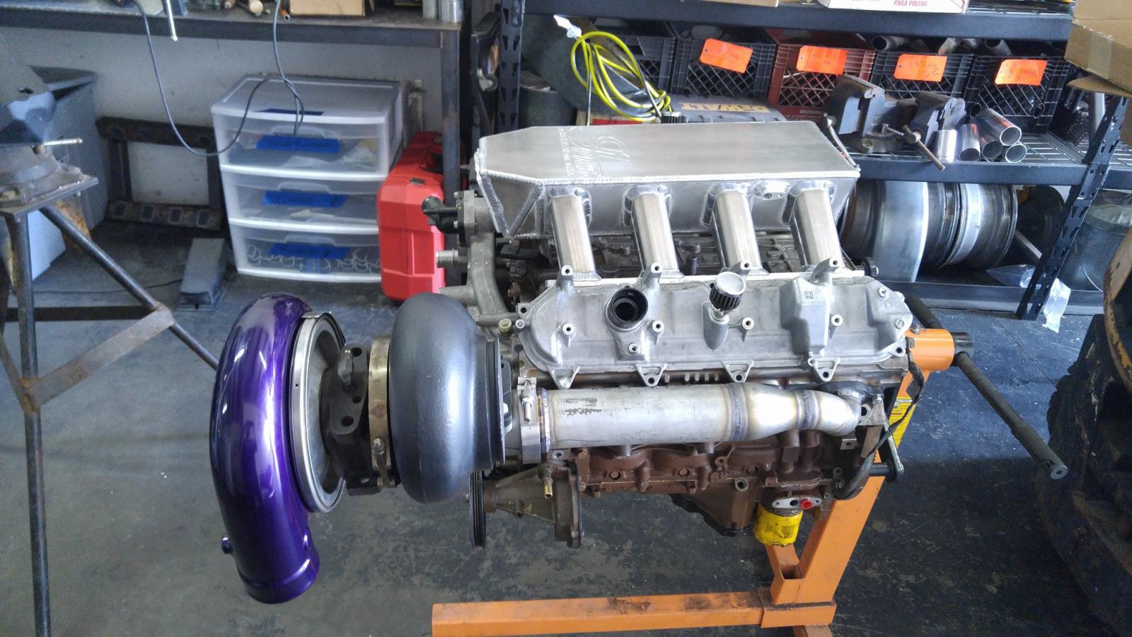

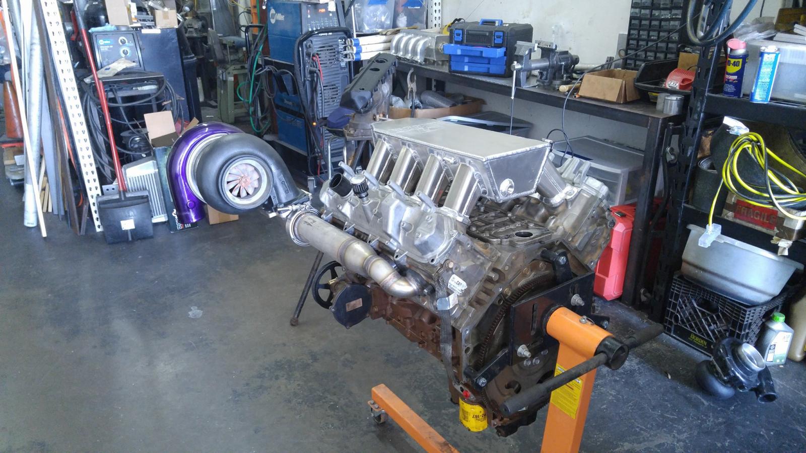

Here is a picture of the mockup engine. This intake is going to a car going to be in Tx Mile next week. The tuner Rick Clark will be doing some before after on stock car as well as the c7 procharger vette doing the tx mile.

Driver side manifold done, now to do the passenger side manifold and connection pipe
