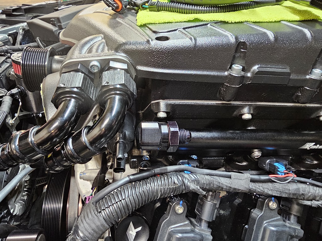

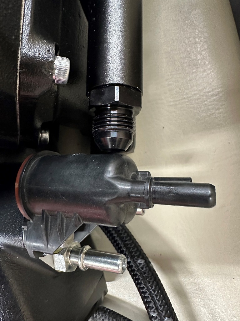

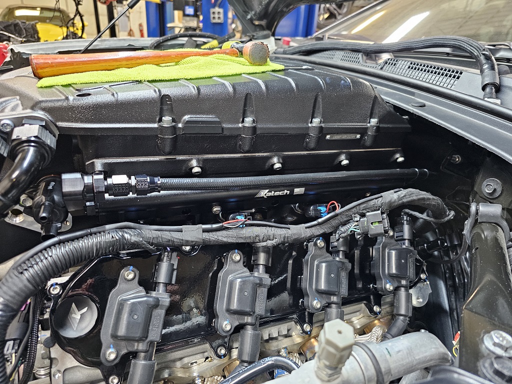

@Nmolina9239 brought light to an issue with the Whipple EVAP solenoid running into the port fuel rail fitting on the drivers side of the blower.
We sourced a super low profile 180 from Fore Innovations and it clears.
Moving forward we will include one of these with the kit.
