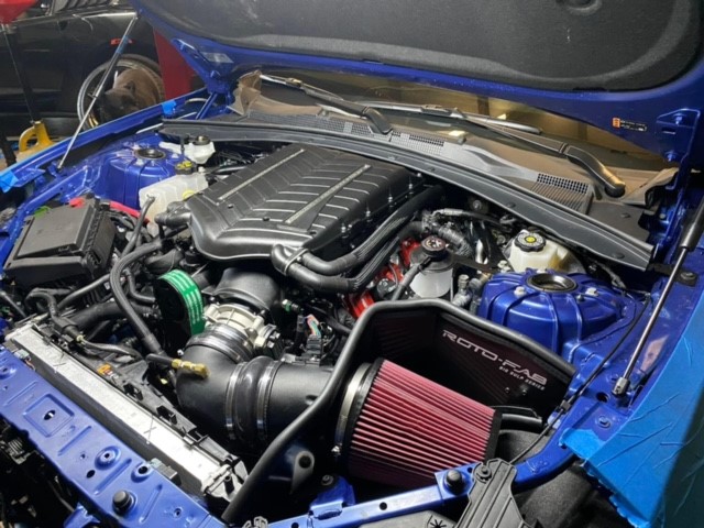

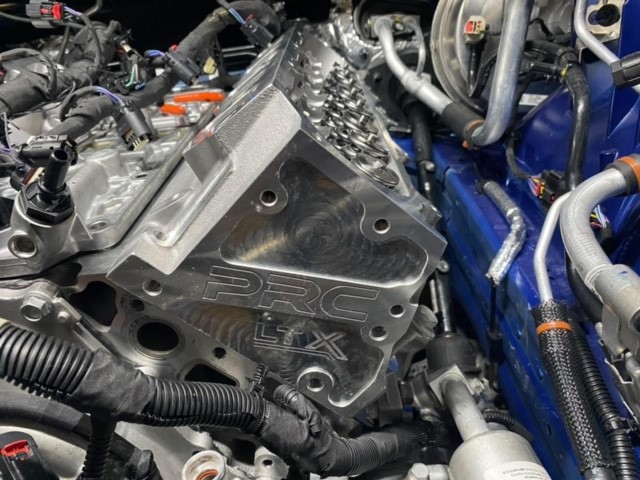

Finally back together for round 2 after the coolant pump replacement. Shop going to put a few hundred miles on it for break in (I don't have time ATM) then hand it over to me for the rest of the miles and oil change. Then back to shop for some fine tuning and a dyno tune and some #'s.
2022 Camaro 2SS/ Whipple 3.0 / 2"Headers/ PRC LTX Heads/ Forged Internals/LT4 fueling/ DSX Aux/
DSX Flex Fuel/ Meth Injection/ Katech 112 TB/ RotoFab Big Gulp/ Corsa NPP/ Various exterior mods

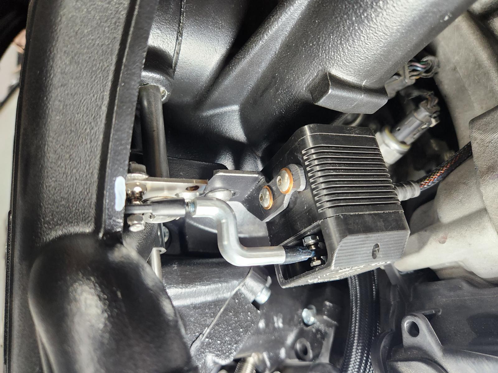

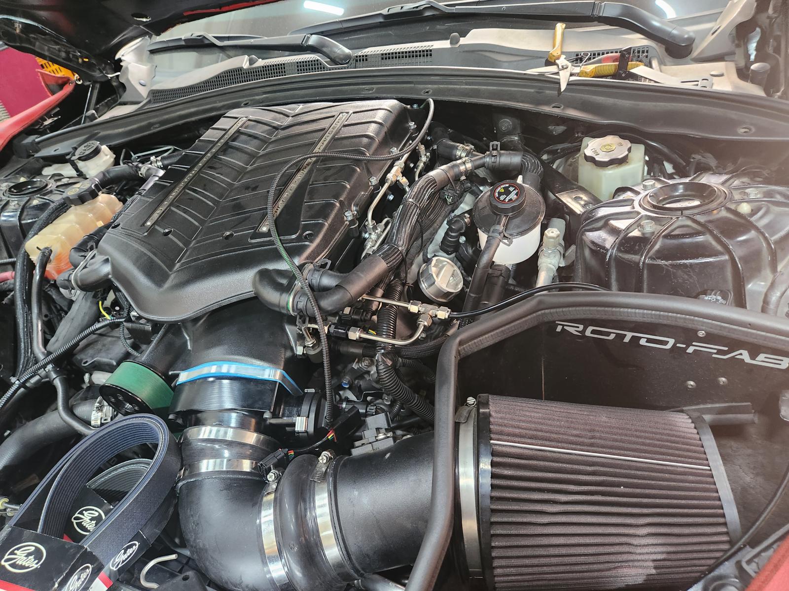

Finally , I got the numbers.
It took quite long time. Lots of extra works..making a bracket for smoothboost, meth port injection tubing...ect.
And was quite lazy due to cold weather here.

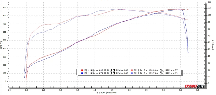

And here is the numbers.
The red one is whipple 3.0 and the blue one is 2650.
Almost the same boost level and the same spakr advance.
Seems it is identical.
The pulley size is
3" / 8" and 3" / 8.85" @19.1 psi around.

Awesome, thanks for sharing. The question now is going to be how overdriven the 3.0 can be without issues, and if it continues to gain power linearly. Next would be how each react to porting. I assume that is a Magnuson 2650?
