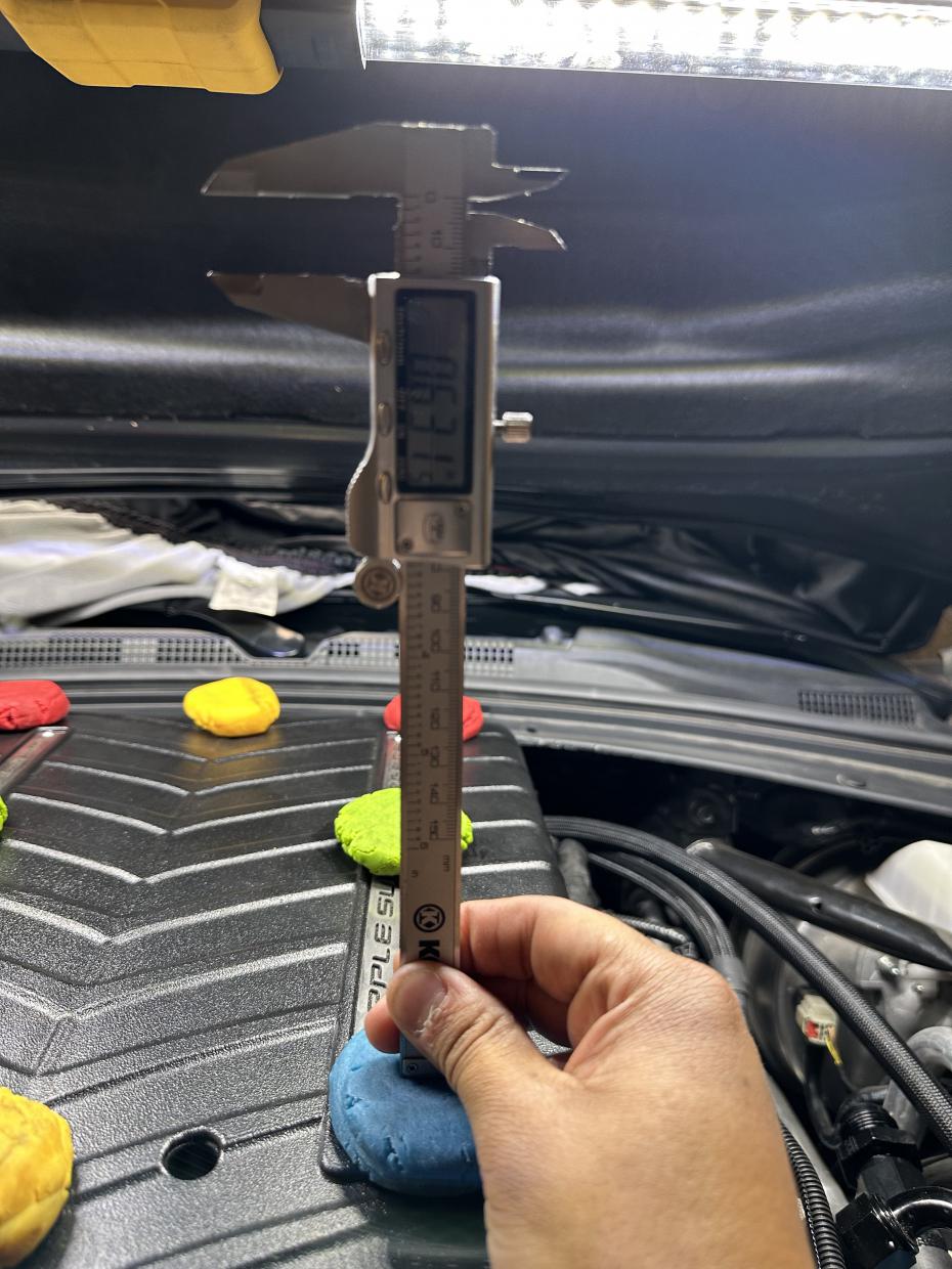

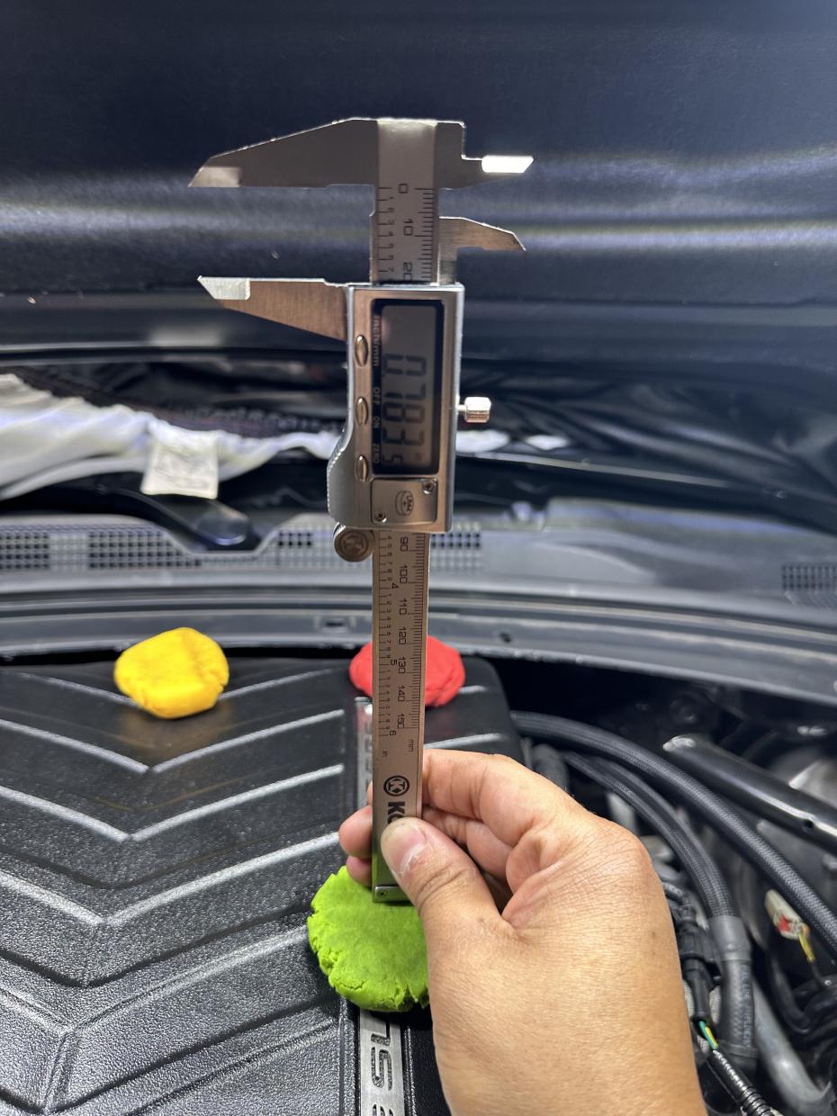

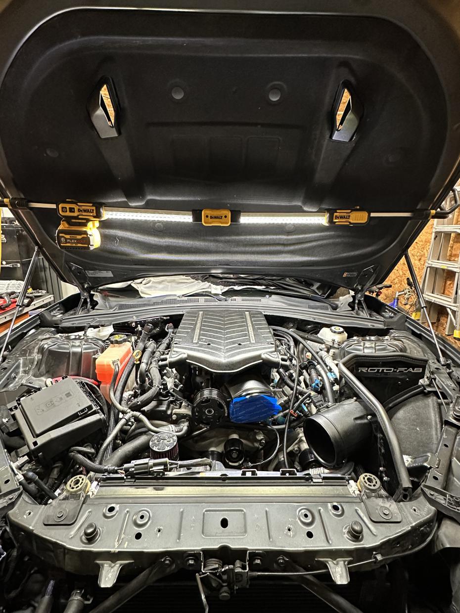

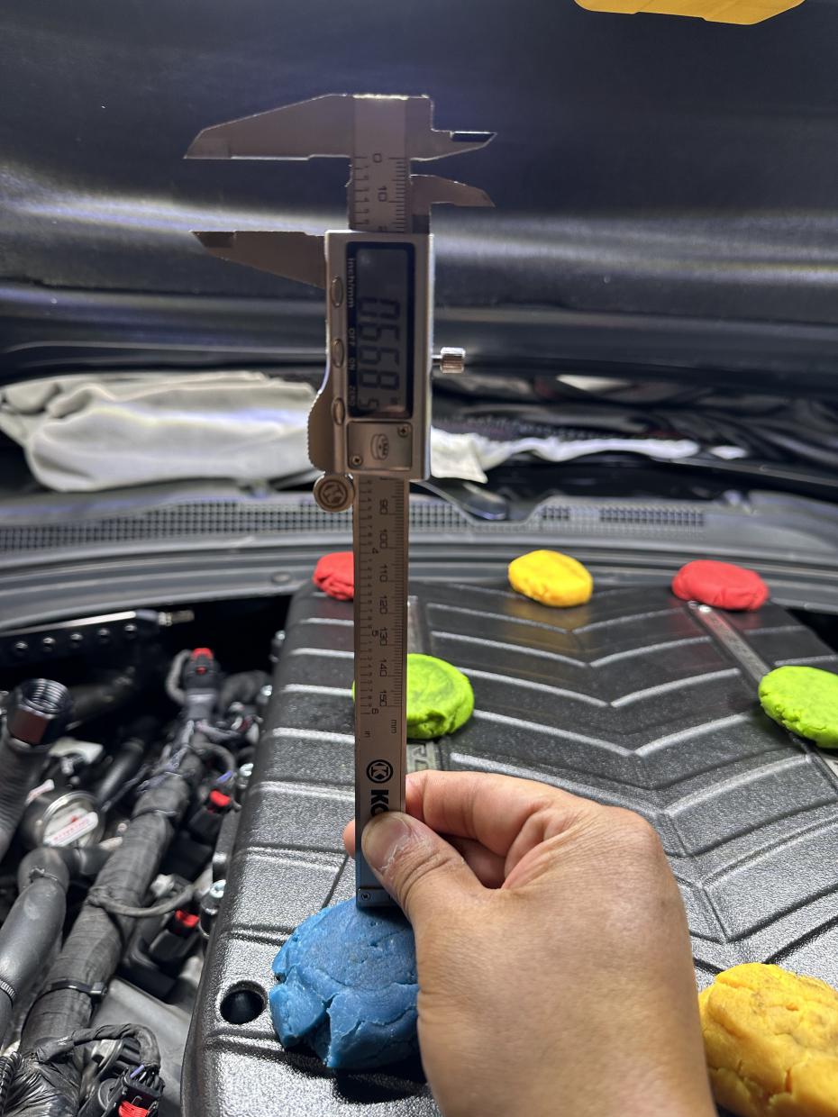

Old 03-15-2023, 07:22 PM   #195
Nmolina9239
Nmolina9239's Avatar
Drives: 2018 2SS
Join Date: Sep 2018
Location: Niverville, NY
Posts: 121
Gents,
I throw the blower back on my car and took some pictures with playdough (yes I have some at home, my gf is a teacher).
I also took some measurements using a micrometer as shown. This is on my 2018 SS with the stock hood (including the felt protector underneath) as well as the cradle lowering spacers as I posted pictures of before.
Long story short, she appears to be a tight squeeze. I had spoken to Grant at TooHighPsi a while back and he mentioned that even their low profile plates are 8/10ths of an inch thick. Looks like machining the intake runners is the way to go unless I'm missing something.
Hope this helps.
-Norm
2018 Camaro, Whipple Charged, RotoFab Big Gulp, Katech 103mm, LT4 Fueling w/ JMS BAP, GPI Drop in Rods and Pistons, Custom Cam, Ported Heads, Kooks LTHs w/ Green Cats and Mid Pipes, Corsa Extreme Mufflers, DSS Driveshaft & CV Shafts, Might Mouse Catch Can, Circle D T.C. #Team GPI
