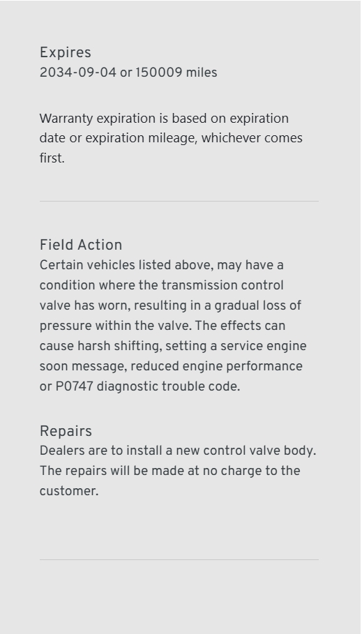

my CAI duct fell off yesterday, but I fixed it really quickly. When I started the car today, a check engine light came on. I thought it was cuz the car was running lean from yesterday. But it seems the CEL is related to TCM... does it mean my trans control valve is f***ed?

My understanding is and when it happened to me with this code was the transmission temperature sensor cable was going bad and would throw this code along with P0711 after a few months before I got the cable replaced. Long winded, sorry
This is from the extended warranty on the valvebody.
