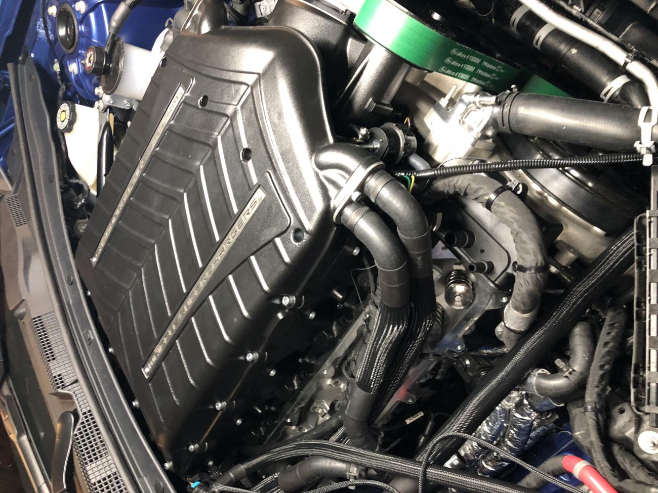

Getting closer to finishing- man that lid is huge on the 3.0
Need to look for a larger TB as the 95 is dinky- looks like a Katech is in my future.
Anyone running the 120mmTB from Katech? Dan @ Katech says the snout needs to be ported to accommodate the 120mm TB, so 112MM may be a safe bet.
