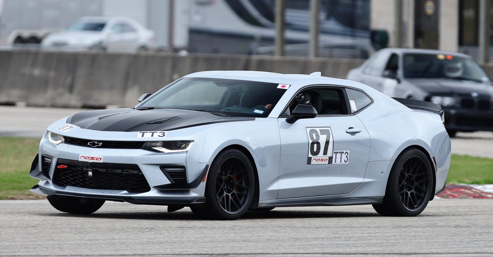

19x10.5 ET22 ARC-8 true square track setup using 305 tires

Great photo!!

Hey carguy55, I am considering running a square setup as well. Did you go with 305/30/19 or 305/35/19? Also did you have to use spacers up front? There are A LOT more options at 305/30/19.

305/30/19 and front 5mm spacer with the strut grind + longer studs

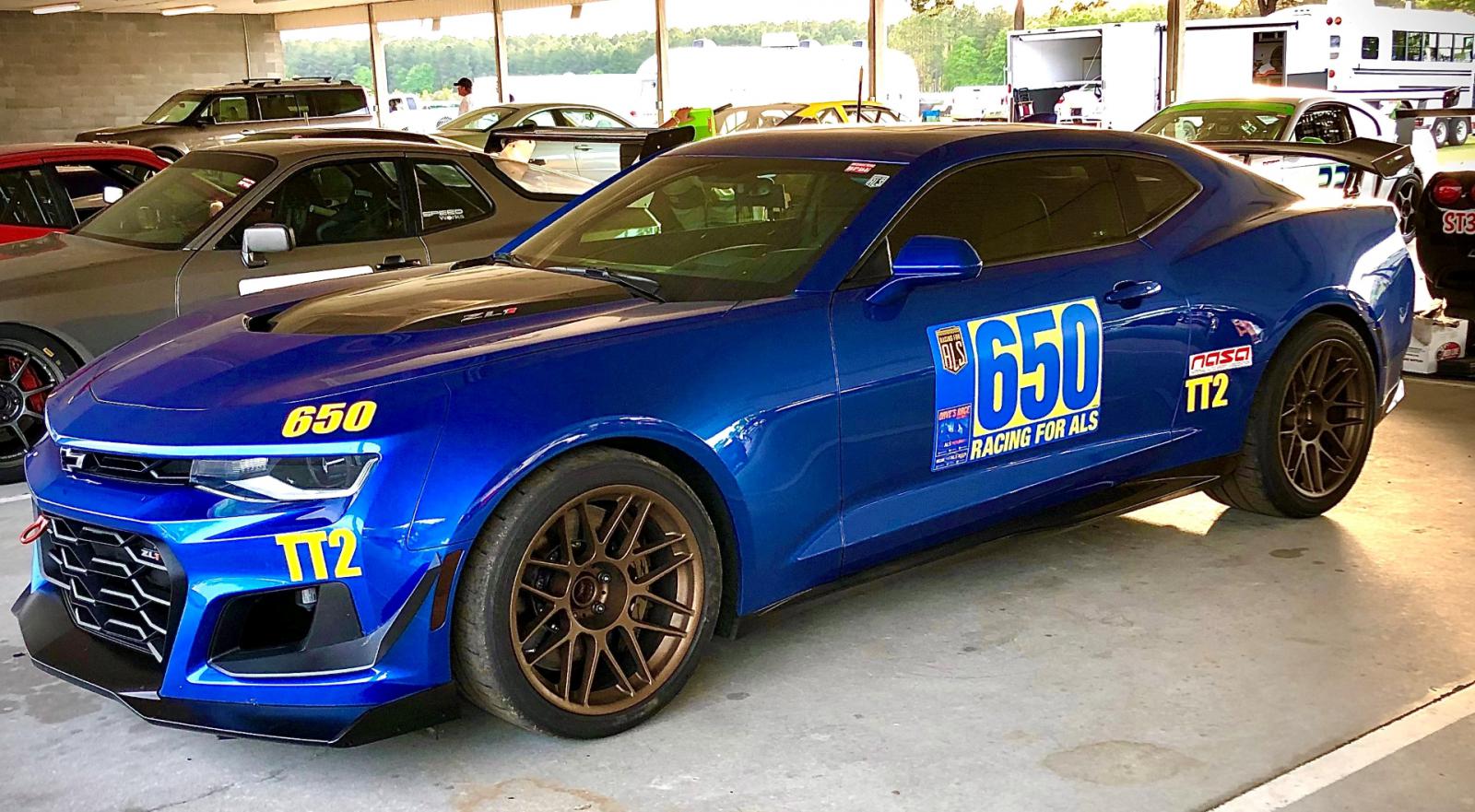

Better photo. The car is stickered up for NASA TT.
  • 2018 Camaro ZL1 with 1LE Aero
  • Apex ARC 8 Matte Bronze, 19x11 ET11 Front, 19x12 ET41 Rear
  • Goodyear Eagle F1 Supercar 3R 305-30-19 front, 325-30-19 rear
  • Shaved front strut, relocated rear driver side wiring harness
  • Camber -2.4 front, -1.7 rear
  • No spacers

Bronze always looks so good on that shade of blue!!
