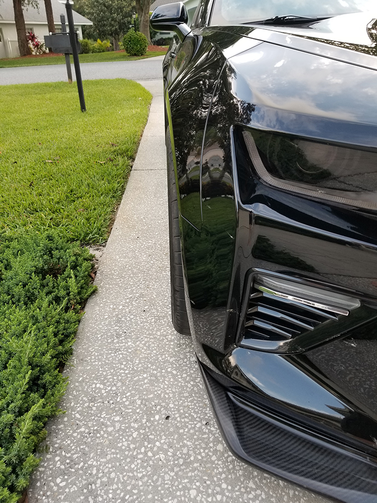

Originally Posted by NYblack1le View Post
Is there any poke with the 19x10 et 20 front(non zl1 fenders) and 19x11 et35 rear ? Would love to see some shots. In for the group buy!!!!
I don't have a before pic, but this is after a -1.20 degree front camber alignment for the 19x10 et20 on a 285/35/19 tire, which is between the stock and GM track spec alignment (-0.75 and -1.50 respectively if I remember correctly). At stock alignment they noticeably poked at the top. My car has MRC and I'm lowered about 7/8" in front and I haven't had any clearance issues.

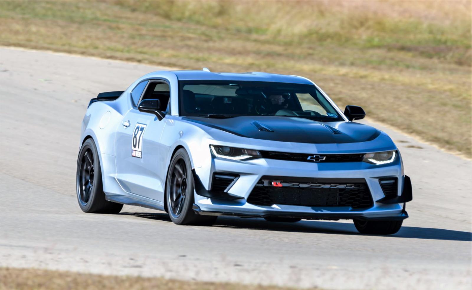

Loving my 19x10.5 ARC-8 true square track setup using 305 tires

Old 12-17-2020, 08:31 AM   #117
RoaringV8
Drives: 2017 HBM Camaro SS 1LE Camaro
Location: South Jersey
Posts: 117
carguy55 - Great pic...car looks good! Is your car lowered at all? You running the SC3 tires?
RoaringV8 is offline   Reply With Quote
Old 12-17-2020, 05:06 PM   #118
carguy55
carguy55's Avatar
Drives: 2018 1SS 1LE
Join Date: Feb 2017
Location: Austin, Texas
Posts: 1,574
Not lowered, that just how far the 10.5 ET22 push out, plus 5mm spacer in front.. Running SC3R currently but may be changing to the SC3 just to see what I can do after experiencing the 3R crack.
