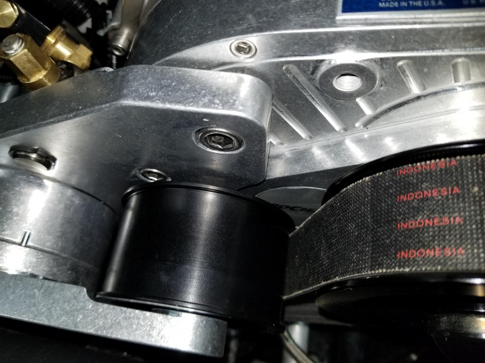

One concern, should the belt be that far back against the tensioner pulley?

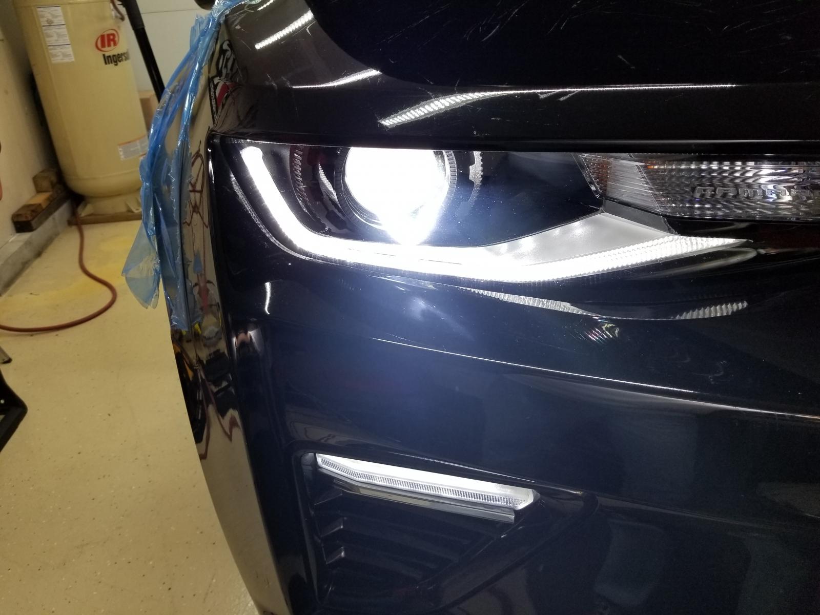

I also installed 5000k HID's which look great.

And those aren't scratches in the paint, I had wreck wrap all over it to protect it, I just haven't removed the sticky stuff off of it yet.

Congrats on the install! The belt looks about right.
