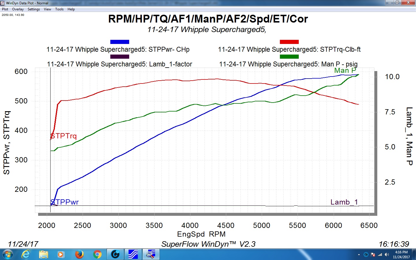

Thought I would share this over here as well as the forced induction section.
Just finished up this Beautiful 2017 Camaro SS Auto for one of our members.
Featuring
Whipple Supercharger Tuner kit
Rotofab Cold air kit.
Jannetty Racing Custom tuning via HPtuners.
592 RWHP 575 RWTQ 93 octane pump fuel.
The Whipple is very efficient and has made the most power to date on the factory fuel system of the LT-1.
We are very pleased with the results.

How much boost?

Boost is the green line on the graph noted on the right.
8 through the middle and peaks at 10 psi at rev limit.

Over 500 ft lbs of torque from 2250 through 6000 rpm lol that's awesome!

It sure is you have to drive it, probably the most fun you can have with your pants on
