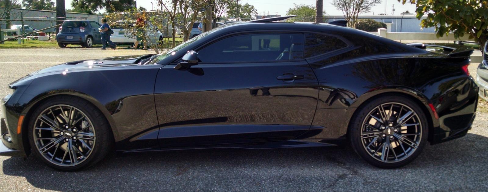

I lowered mine with Eibach Springs. Took the time for DYI in my garage and I am extremely pleased with the results. Aligned within 50 miles after install and bought lifetime alignment, so I can align whenever and if the springs settle more and throw off alignment. Time consuming project, but knowing I did it myself is priceless!!!

Thanks for sharing. I was thinking of tackling it on my own as well. Was the install pretty straight forward? I have installed lowering springs on some import cars when I was younger, but I am not sure if there is anything in particular to watch out for/or be concerned about with the MRC or anything else...? After seeing your photos and Stephen's photos, I like how the front end of your cars sit. I am not really worried about the rears, just the front. If you have any words of wisdom, it would be appreciated

Ensure you have the correct box wrenches; they seem to work better for the back and just take your time. If you have someone to assist, you will save some time lining up the link holes in the rear. I used jack stands, but it would be much easier with a lift. Finally, I watched the video and used it for reference a couple of times during the install.

You can use the link above or search google for 17 ZL1 lowernig spring install and select video. It shows BMR spring install, but it is the same process.
Nice pic, can you cofirm me the distance from floor to front and rear Fenders?
