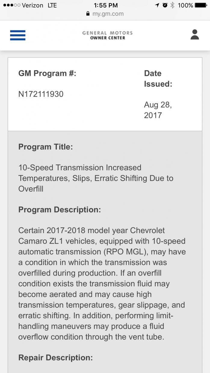

Official recall on A10 Trans in 17/18 ZL1s?
Got my little onstar email report today and noticed this. Mine has been fine so far. Hard to tell if all are overfilled, or just some with their working.

Overfilled during production? How does that happen...

Seriously, because draining 2oz of fluid out of a Trans warrants waiting years to buy a car! Hahahahaha

I wonder what is considered high trans temps? They need to tell us what the normal temp is supposed to be. I've thought the temp seems to run on the high side myself, but most everyone else seems to say theirs does too, so is that normal or not? I've not noticed any gear slippage or erratic shifting, so maybe mine is fine. Mine is usually around 185-190.
