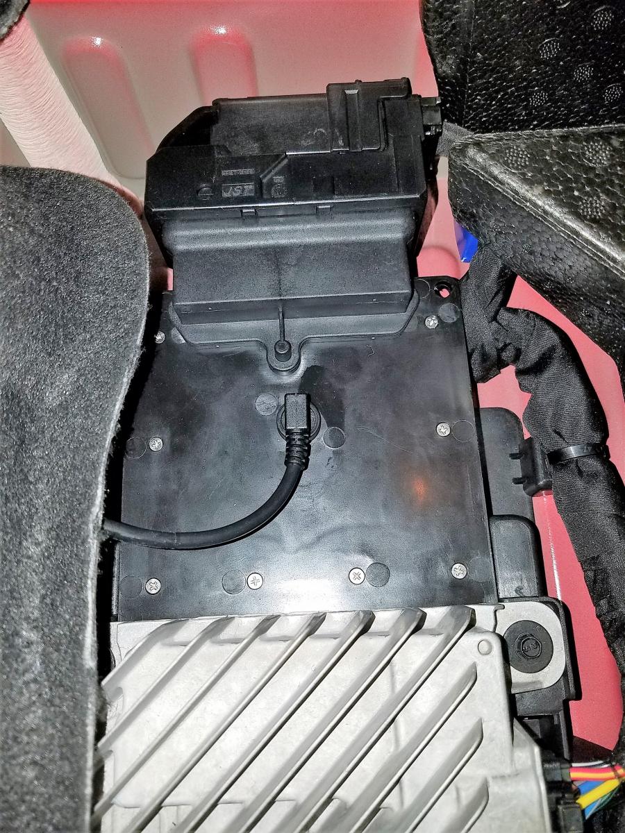

The installation instructions say “The DSC Sport V2 controller is not a perfect fit for the OEM bracket.” Actually, it doesn’t fit at all in the original slot for the old GM BCM. I mounted mine just under the Bose amplifier with the amplifier screwed down gripping the controller. As you can see in the picture below, the DSC controller sticks forward about 3-4 inches from the original controller position. That’s OK. It allows access to the USB port.

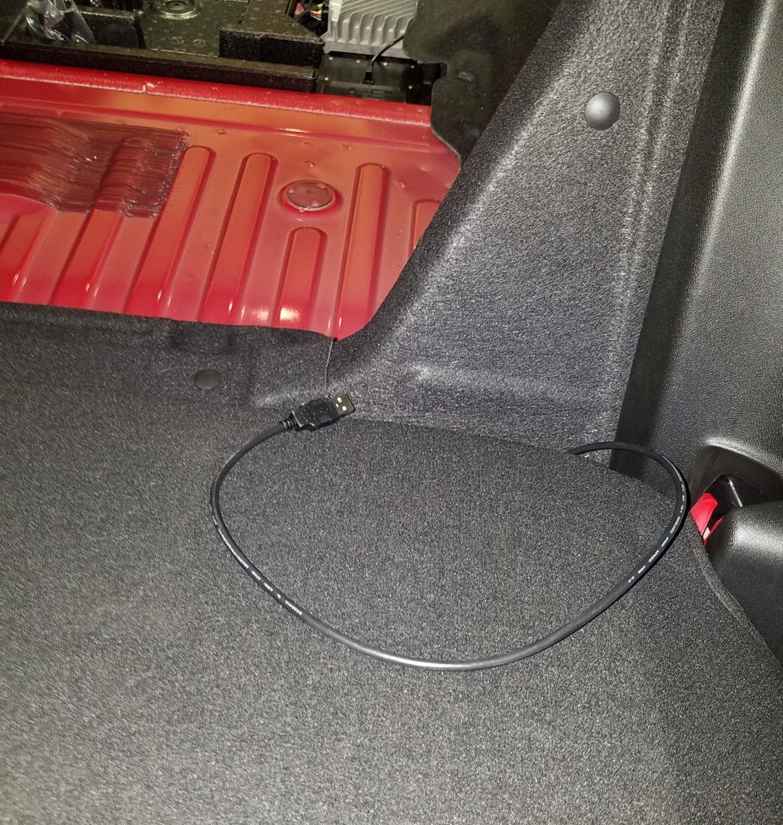

I routed the USB cable through the back seat and left it there. When I want to hook up the laptop, I have a 6ft. USB extension that I tie into this cable and it allows me to have the laptop in my passenger seat. This may all go away if I can figure out the WiFi connection in the future.
