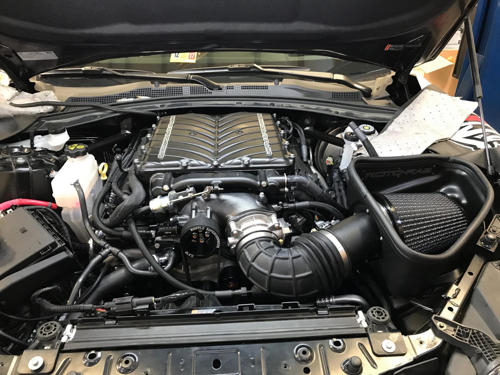

Where is everyone placing their nozzles for meth? The intake tract is not long at all we barely have room to mount them on a flat surface. Additionally I'm getting a Whipple supercharger and must use the stock accordion elbow piece to connect from CAI to throttle body and that creates even less room to mount nozzles to a hard surface. Direct port meth is not an option with the Whipple either.

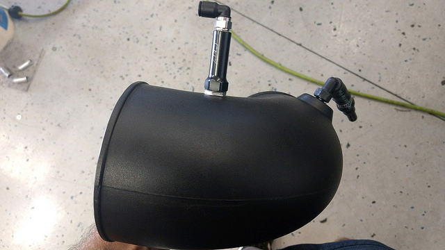

I see what you mean. A local shop that did this one on a LT4 had hard plastic vs what I have.

one more pic

Supposedly the RotoFab elbow can be trimmed to fit with the Whipple blower but still at an odd angle per Whipple directly but I don't have any of those parts here yet to check myself.

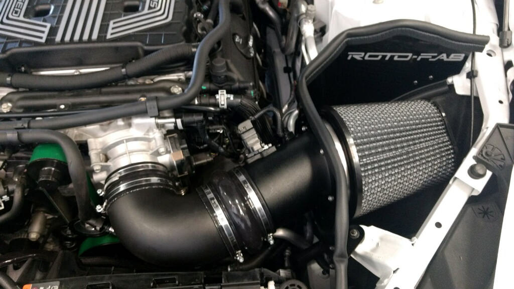

I'm running it in the elbow of the Roto-Fab CAI. It sprays directly back into the TB
