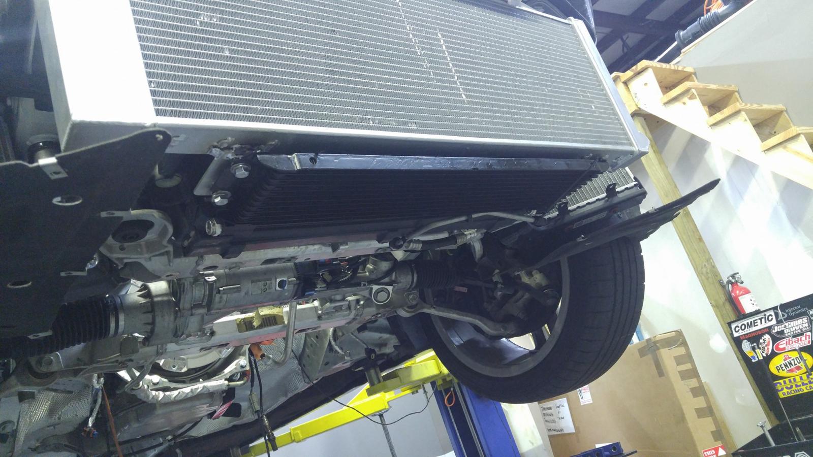

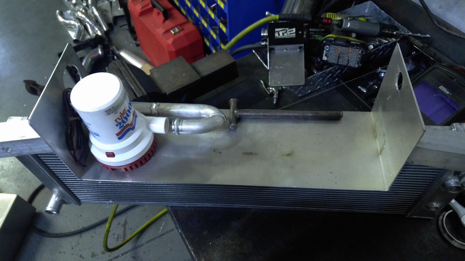

You mean something like this?
This was prototype 1
prototype 2 is going on my car with a few revisions,
3rd should be perfect...
I'll be using the rule 2000 pump in mine but if it ever goes south I'll switch to a stewart emp pump
Can do it without the pump as just a resivor and radiator for a upgrade as well
Bolts in all factory locations...setup for 1" water lines
Is a modded jeep cherokee radiator with custom 3 gallon resivor over it, all in all between intercooled intake, resivor, lines and radiator I expect it to hold nearly 5 gallons
There is a tad more room for a bigger resivor also, I think I can get another gallon up top without much hitch
Goertz is offline   Reply With Quote

That's awesome, is it an upgraded engine or intercooler radiator/coolant-tank? My need is only for the coolant tank, not intercooler radiator. FI Interchiller recommends removing the SC intercooler radiator.

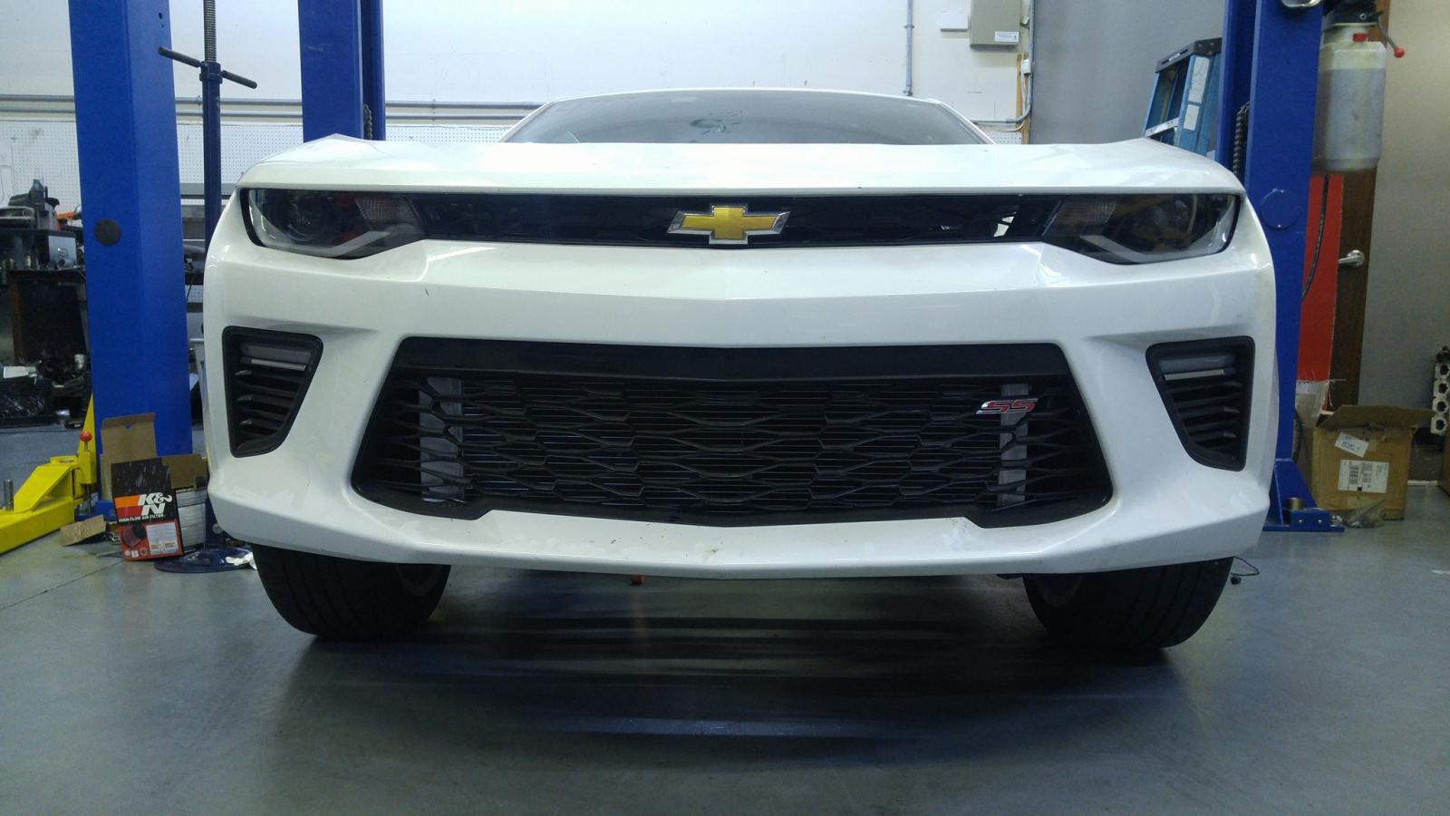

Now that's pretty slick! Just don't ever get in a frontal impact without that crash support.

currenlty only a radiator/resivor compound
the radiator (heat exhanger as most call it) oem should always be the first thing upgraded in a oem air water system, the stock ones love to heat soak

frontal crash bar is really only low speed good in these cars, I can beef up a crash bar to go on it if someone wanted
if my car ever wrecks it will likely be much higher than posted speeds and not really matter at that point lol
