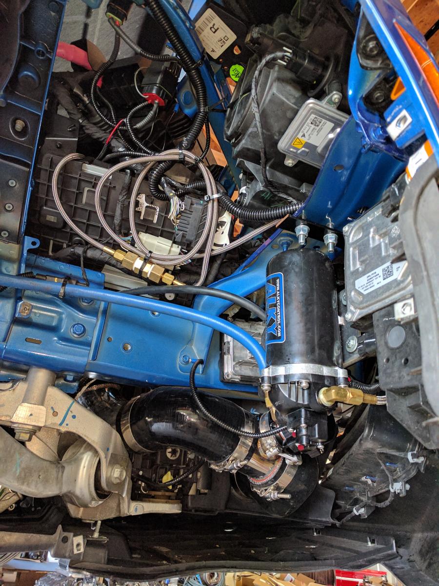

here is a undershot of the install of the alky kit under my right wheel well. There are 2 lights on my dashboard one is a low level light indicator and another is a monitor light.
