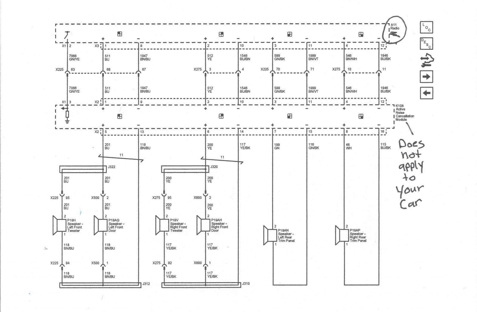

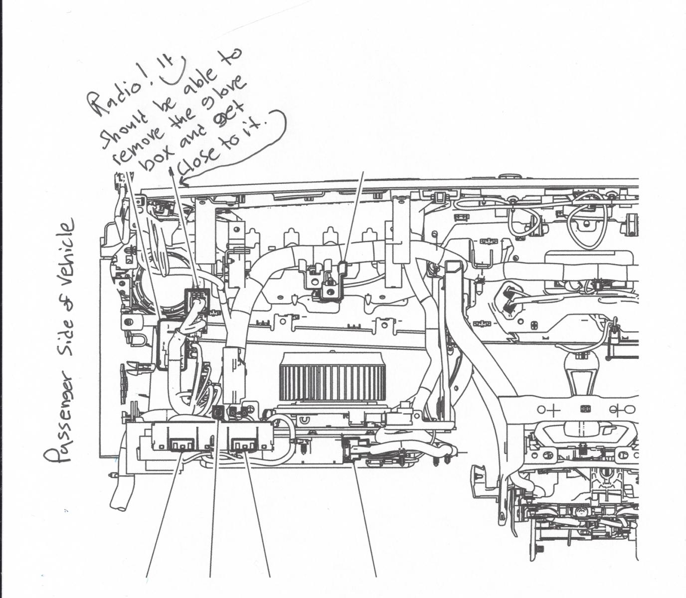

I had a service writer look it up for me. The SS 1LE specifically doesn't have a separate amp, like we deduced. It just has the 8" display and the "receiver", which is located fore of the glove box. Here's a drawing I was given, the perspective is looking from the front towards the aft of the car.
I was also told there isn't the ANC in the SS 1LE, due to the lack of a normal amplifier, however the wire colors going to the speakers is still the Blue+ & Brown/Blue-, and Yellow+ & Yellow/Black- for the front speakers. Sourcing from the rear speakers is an unknown and might not be full-range. Use at your own risk obviously.
Based on my searching in my own car it appears the easiest way to tap into the front channel high-level signal is at the bulkhead connectors behind the footwell kick-panel trim. It's not easy to get to, and you'll have to cut factory wires to splice in an external amplifier.
I hope this helps.

The SS 1LE has no external amp, no rear deck speakers and no center dash speaker. That means there are no readily accessible speaker inputs in the trunk, and no premade adapters fit this setup.
I spliced into main stereo wiring in the dash, then ran new wire to the trunk to connect the audio control LC7i, it converts and creates rca outputs for the system amp to power the speakers. The factory speaker wiring was disconnected from the speakers and new wiring was run from the trunk to each location. I also added the acr-1 remote bass knob to the console from the LC7i.
