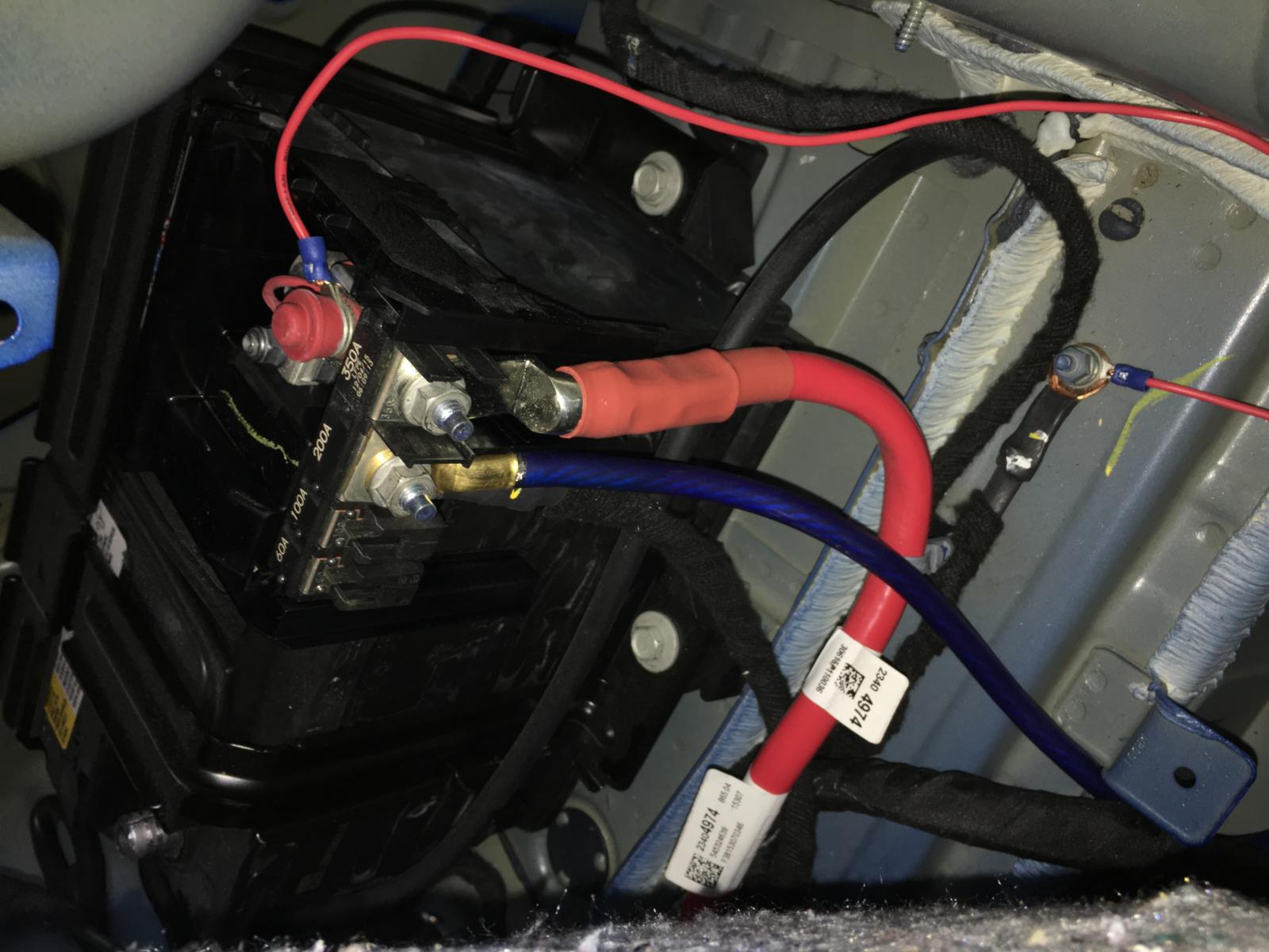

Hey guys I'm wiring up an amp and sub and saw this when I got to the battery. Anybody know if I can buy a wire end plug in for that 60amp spot? I've called 2 different chevy dealers and they act like I have 2 heads.

Most of us tap into one of the others on the other side. Just make sure you put a inline fuse 18" away that your amp manufacturer recommends.

To all who helped, thanks. After going to chevy and looking with the parts department at schematics, there is no amp in the 1LE anywhere. I ended up taking the plastic interior panels off of both sides and can confirm there is no amp at all, so i just tapped into the speaker wires there and ran those through the back to my amplifier and sub. I guess we really have the lowest of the low in Camaro sound systems
