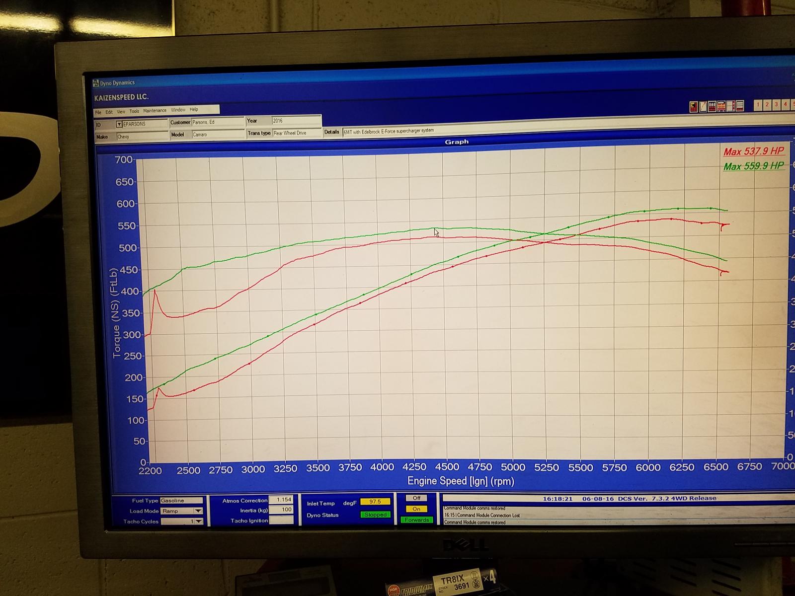

Here's my dyno run with the all the nannies off/on. Be sure he does the full 10 sec hold on the mode switch to shut them completely off. Took us a while to figure this out.
