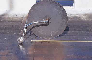

Just about all the advice given so far has been spot on so I'll just add my .02 and talk about rollout. If you are looking for the best ET and not worried about reaction time then shallow staging is your best bet. You can increase your rollout (the time it takes before your timer starts) by pre staging and then creeping up until the staging bulb flickers on, you will have approx 6 inches or so to roll into the guard beam before your time starts. The 2nd pic below shows the 3 chalk marks.
My 11.80 pass in my Sig if a good visual of shallow staging, watch the bulbs. We need more members in the 11 second club so make it happen !!!
