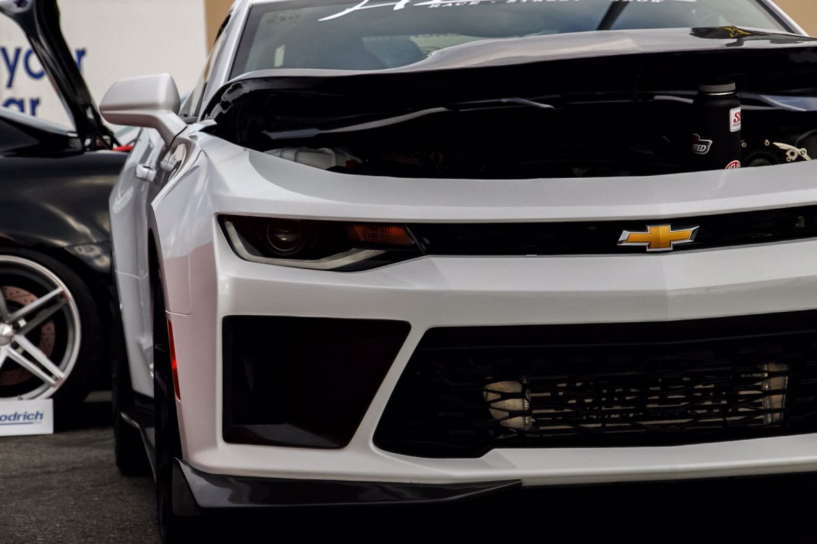

Originally Posted by Subperfect View Post
You'll still be able to to see the IC through the grill
Attachment 836555
Paint it black and it disappears.
I might just do that .... along with the fact that you can't really hear the supercharger much until you get on it I really like the sleeper factor right now
